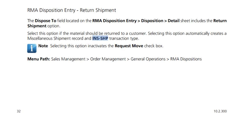

This is the instructions out of the 10.2.300 feature summary guide provided for this upgrade. Our customer service staff are planning to use this, and I’m not able to find where/if it hits the general ledger anywhere.

In a nut shell, it looks like they are saying the “INS-SHP” is to undo the “RMA-INS” tran (that happens when you receive an RMA), when you want to reject the RMA, and send it back to the customer.

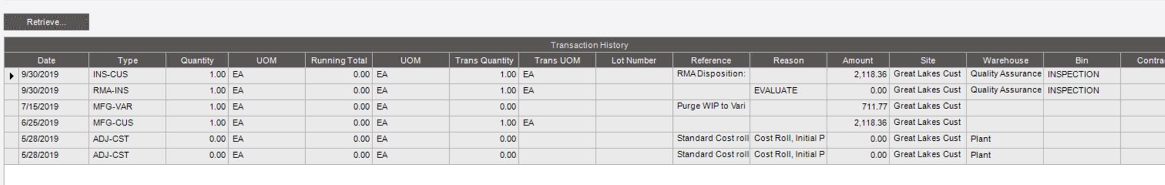

Here is my part transaction history. None of this shows up on the WIP Reconc. nor does it show up on the general ledger. I just assumed if mfg-cus shows on WIP that the ins-cus would also as it does show a value going out… My WIP reconc
has no filters & includes posted & unposted transactions.

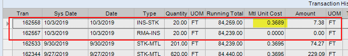

After doing another test of an RMA (This time with a part with non-zero cost),
I get the following in Part Tran History:
And this in WIP/Recon:
The RMA-INS doesn’t show on the WIP/Recon. We don’t use Inspection in E10, so I don’t know if a PUR-INS (for receipt of a PO requiring inspection) shows up on WIP/Recon either.
I guess I would expect to see the ins-cus to also be Zero. I’m fine with that, just am unsure as to where/if the $$$ attached to the ins-cus would be going somewhere.
