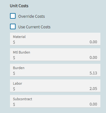

I’m being asked to present data about our RMAs that we’ve received back and the cost we’ve associated with each. I see the costs on the RMA disposition screen but those fields don’t map to a database table. Does anyone have a way to get those costs so I can present in a report?

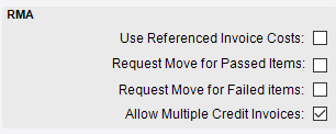

What is your settings for RMAs in Company Configuration?
We’re in 2021.2 - The closest thing I see to settings like this is:
Is this what you are referring to? If not, where is that?
Look under the Sales Order tab. I think it is under Sales?
That is good. I never use the “Use Referenced Invoice Costs”.
When you create an RMA, do you tie it to anything? When an RMA is received, it does not go into Inventory, but a cost is associated with it based on either the associated transaction or the parts cost. You should be able to grab the cost from PartTran for RMA-INS after it is received. Once it is in Disposition, the cost can be seen and overridden through the Disposition.
Once the Disposition is done, you should be able to get the cost from PartTran for the corresponding disposition type. I think they are INS-MTL, INS-STK, INS-DMR, and I am not sure what the transaction type for Return to Customer.
