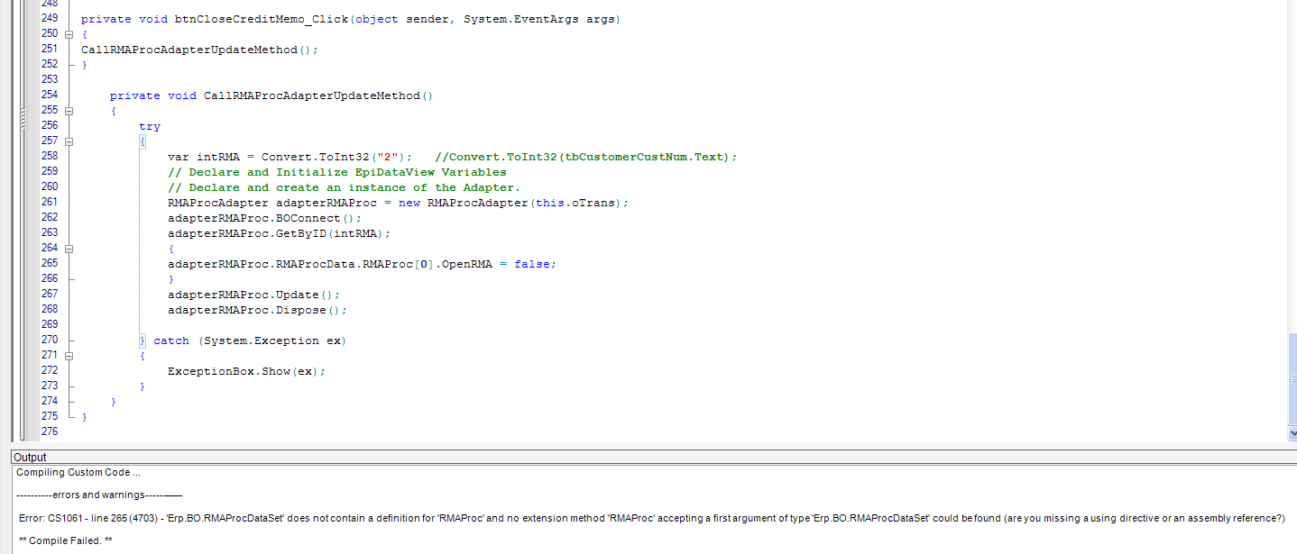

I want to update the RMA record to close an RMA with a button click. I have the code below so far but am getting an error:
	private void CallRMAProcAdapterUpdateMethod()
		try
			var intRMA = Convert.ToInt32("2");   //Convert.ToInt32(tbCustomerCustNum.Text);
			// Declare and Initialize EpiDataView Variables
			// Declare and create an instance of the Adapter.
			RMAProcAdapter adapterRMAProc = new RMAProcAdapter(this.oTrans);
			adapterRMAProc.BOConnect();
			adapterRMAProc.GetByID(intRMA);
			adapterRMAProc.RMAProcData.RMAProc[0].OpenRMA = false;   **//THIS LINE IS ERRORING!**
			adapterRMAProc.Update();
			adapterRMAProc.Dispose();
		} catch (System.Exception ex)
			ExceptionBox.Show(ex);

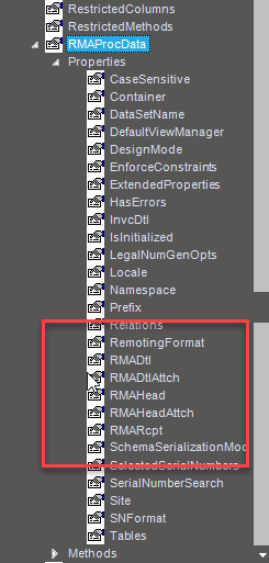

Right, you need to reference a data table within the RMAProcData data set
Not quite the same, but this will work:

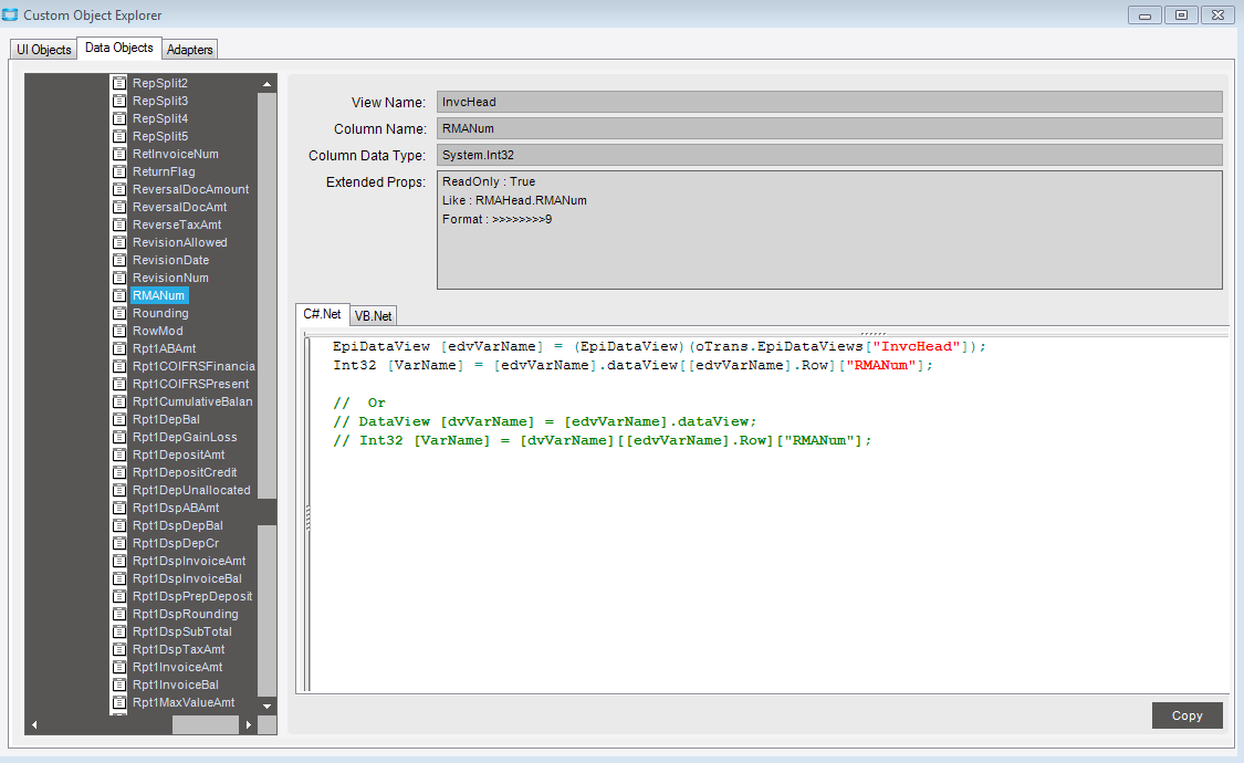

You’ll want to get ahold of the rma num from the dataview (I’ve seen you do this before so I have faith you won’t need the code!) and then either create a variable from it and pass that variable into the method or you can directly pass the dataview value into the method
Ha, I just reread an old answer from you! I think I got it figured out…thanks for the confidence lol. These dataview things always stump me!
			EpiDataView edvInvcHead = (EpiDataView)oTrans.EpiDataViews["InvcHead"];
			var RMANum = edvInvcHead.dataView[edvInvcHead.Row]["RMANum"];
