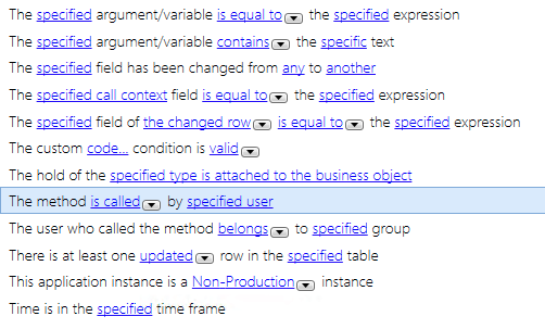

Does anyone has an idea how can I run a Custom Code BPM when an specific user is interacting on the screen. In other words the BPM will only run when a particular user is doing the updates for example…

There is a Condition for that.
And I would probably use the one below it for specified group. You can then make it easy to change when a person is out for a while or if you want to test it.
