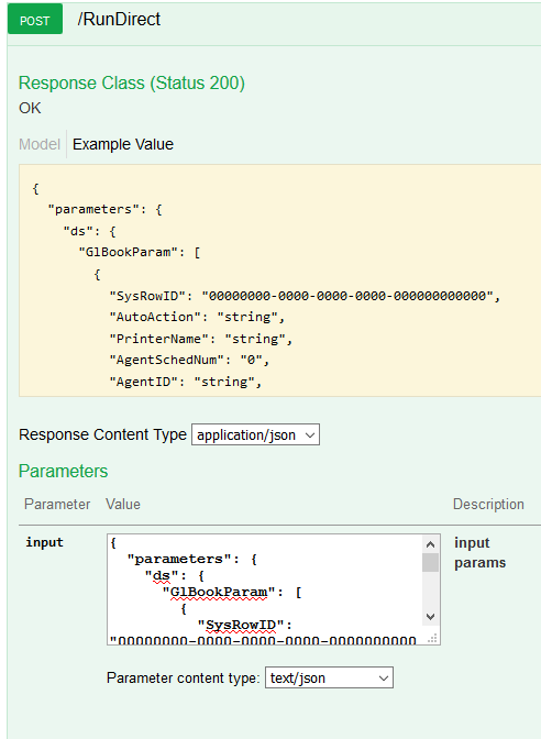

In order to automate our upgrade process more, I’m trying to run reports via REST. I did a trace and went too the Open API/Swagger screen, copied the Input example and filled in the trace values. When I try to submit the report to the TaskAgent, IIS returns a 500 saying it cannot find the parameters in the input. Here’s how I’m calling it:
and here’s the error message:
The parameter is certainly there. :thinking:
Start at the ds node (remove the parameters)
The JSON has to be formatted incorrectly. Try this linter https://jsonlint.com/
