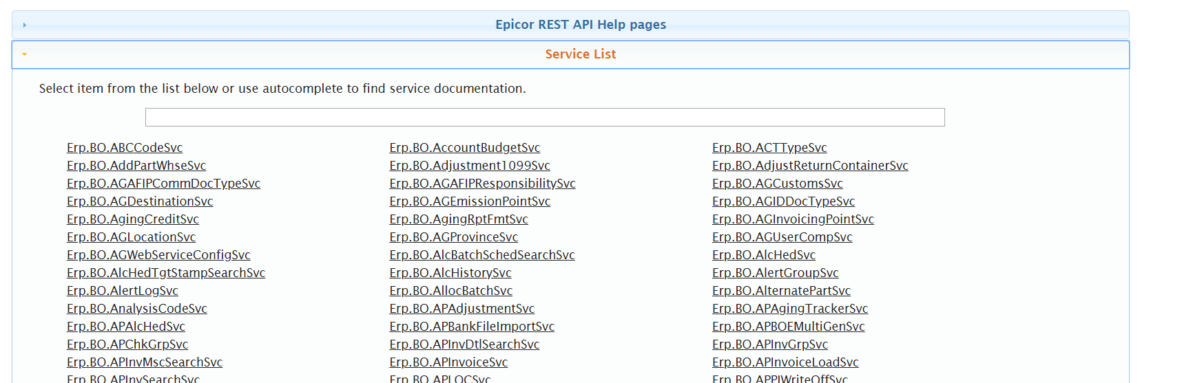

Realised that the service list was hiding the required services in order to trigger prints
(ERP.RPT methods arent shown in service list)
Was able to find and call the methods by manually typing in the method into the url bar

api/help/odata/Erp.RPT.StockStatusReportSvc/index
Huh, I was expecting it in the Custom Methods. Thanks!

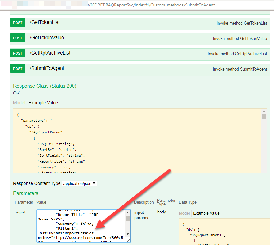

I’m pretty close I think but has anyone had luck posting to the BAQReportSvc method SubmitToAgent?
The part I’m a little hung up on is the where to get and what format to put the Filter1 value as.
Obvjoulsy copying the XML from a trace log isn’t working so well, but I’m not entirely sure what Filter1 is looking for. In an XML trace, this seems to be filling out the BAQReportDataSet, but I’m not sure how to get it into this call…
So that’s a “Serialization” of the DynamicReport data-set… its gonna be tough to get that through JSON…

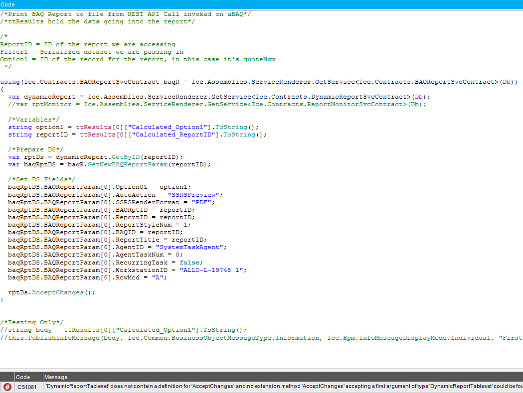

I have made great progress with the method you’ve demonstrated. Since it was through a BPM, I think I need to use ServiceRenderer rather than WCFServiceSupport. Using that, I was able to get to the point where I am am telling th DynamicReportTableset to “accept changes”, where I then get a “DynamicReportTableset” does not contain a definiton for “AcceptChanges” blah blah blah.
I have a feeling this is probably due to a “Tableset” vs. Dataset issue, but how did you get around that?
It is because of the Tableset, vs DataSAet you should be able to do without the AcceptChanges
