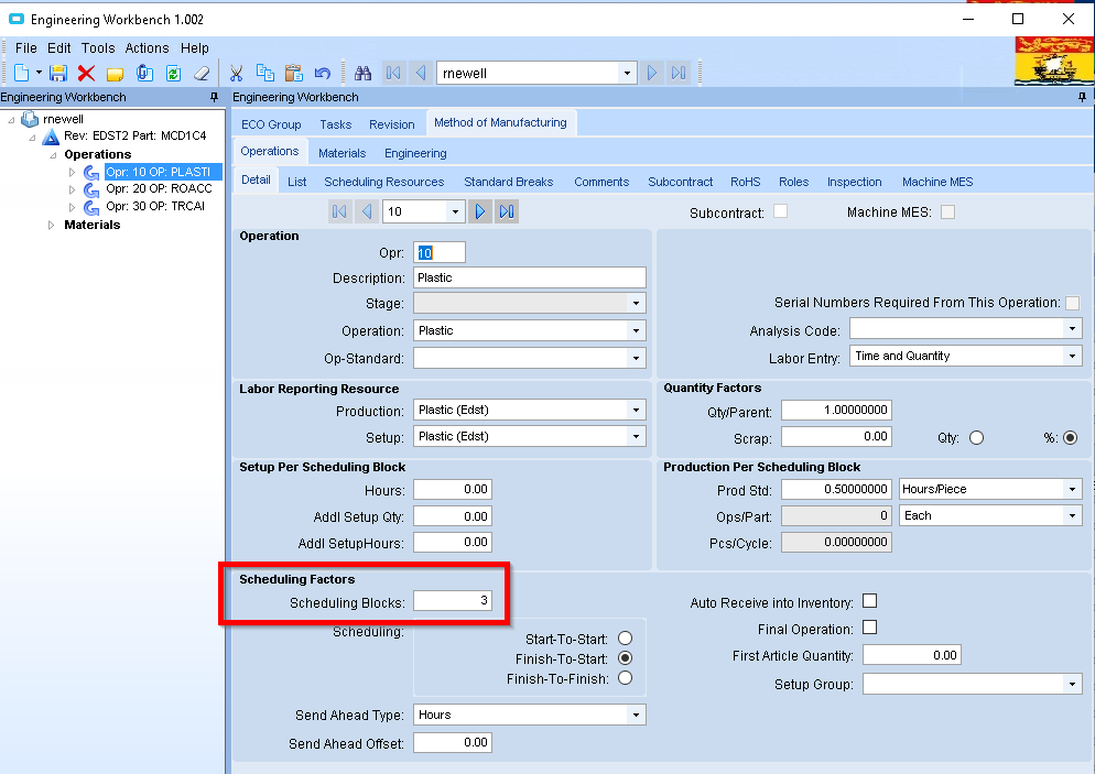

it seems to me that within the engineering workbench, you do not have the ability to specify the number of scheduling blocks.
(EDIT: I admit it… I was mistaken. Read the answer below posted by @rnewell - You DO have the ability to add scheduling blocks in the Engineering Workbench!).
That is something that only jobs have. So when the “get details” is done, it is retrieving the operations, and then the resources, but not doing it the same way as when you manually add an operation. I guess that this could be considered a missing feature… you could go to Epicor Ideas and submit a new Idea to see if you can get people to vote for it.

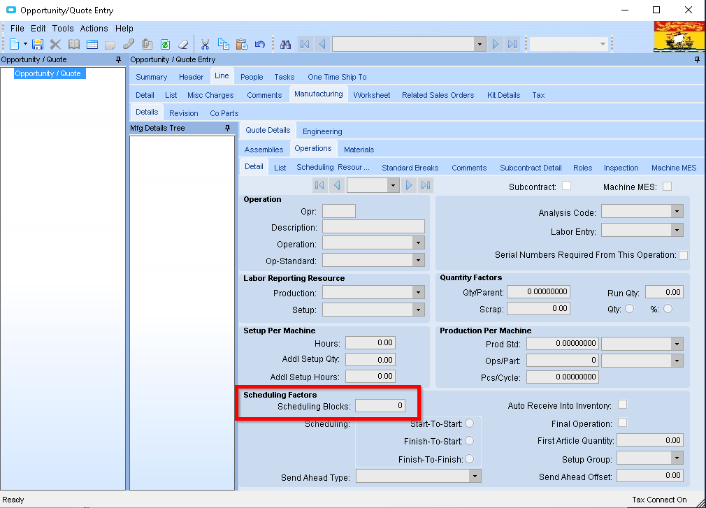

Correct me if I’m looking at the wrong issue but in my Engineering Workbench I use a field called scheduling blocks and this copies into my job as expected when I use the order job wizard. If you don’t get the method from the engineering workbench where are you pulling the methods from? A linked quote or templated quote or job?
I saw the scheduling blocks field in the Engineering Workbench as well. That’s all well and good-- however the jobs in question are not originating from this workbench. Our jobs originate from a Linked Quote. I could not find scheduling blocks on the Quote Opers but I will take another look.
The field is on the quote, we use it this way a lot and I can confirm that it does come into the job.
I (mistakenly) looked in SQL and not in Epicor for this on the quote oper and didn’t see the field I expected. This looks like it will solve our problem if I can get that field to create with the proper value. Thank you Ron-- your input is much appreciated sir.
In sql the field is actually “MAchines”, this is why I didn’t find it. My mistake.
one more edit-- the reason ours are being created with 1 is because we have a customized program that creates the quotes externally from epicor, and the quotes are created entirely with C# from a separate manufacturing software. This has identified my problem perfectly and I will get to work on solving it! THANK YOU!
