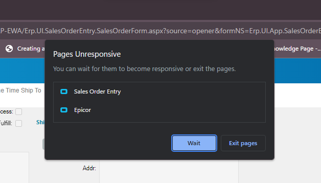

Sales Order with thousands of Releases
We have a sales order with 87 Lines, and 9,706 releases spread out among all of those lines.
When we load that Sales Order in the Sales Order Entry screen, it takes between 45-55 seconds to load.
When we try to Close or Reopen a release, sometimes it works, however we are receiving this error very frequently (this pops up after the 180 second timeout period is reached):

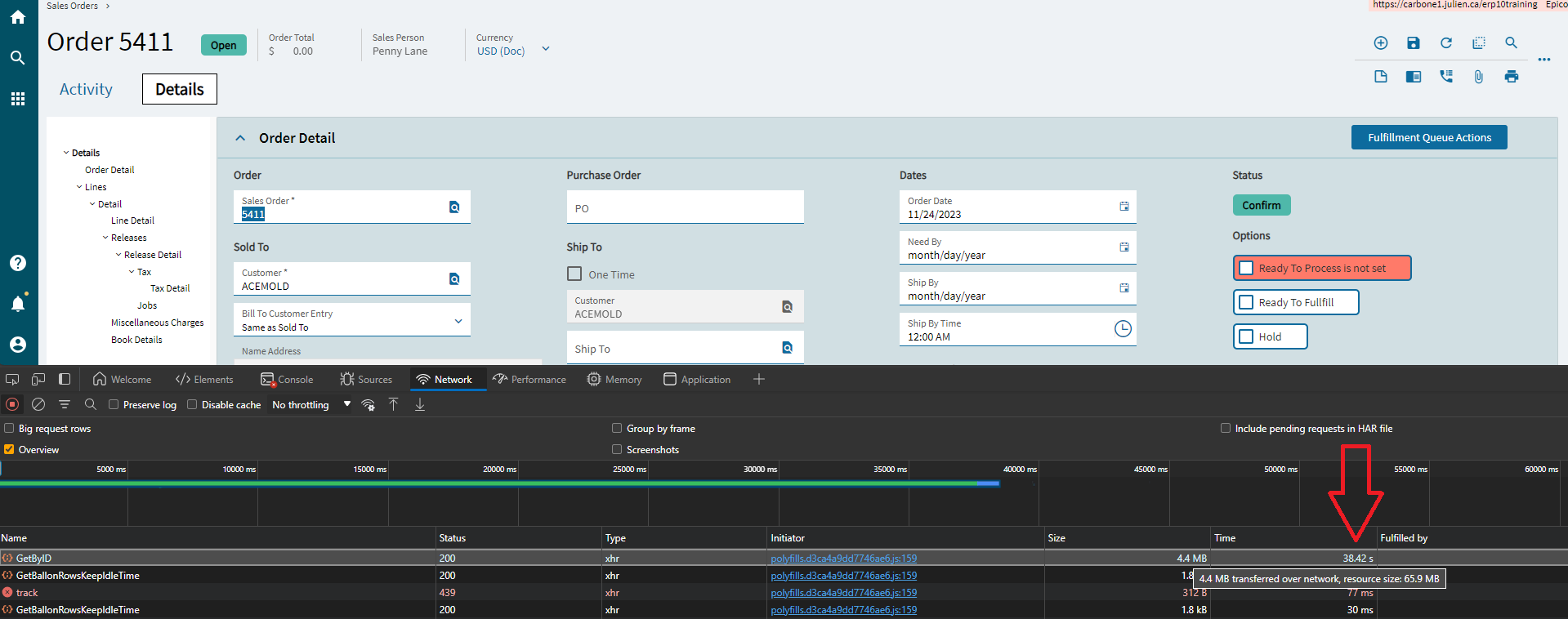

Just tested in a Demo environment, 2023.1.12.
Created an order. Loaded 100 lines, and 100 releases per line. A total of 10 thousand releases for the order.
In the Kinetic web Order Entry, after selecting the order, Epicor calls the v1 API SalesOrderSvc/GetByID method.
The whole SalesOrderTableset is returned and stored in dataviews.
By whole, I mean the OrderHed and all its OrderDtl, OrderRel, OrderMsc, attachments, etc.
As you can see in the screenshot below, that’s a huuge JSON response to transfer from the server and to handle by the browser.
