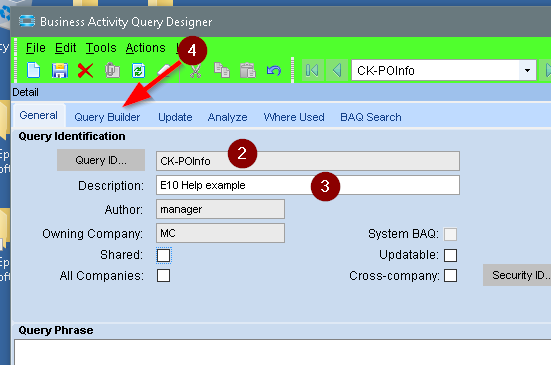

  1. Launch “Business Activity Query”
  2. In the form that Opens up enter a name for the BAQ (I always start min with my Inititals), and hit tab. Answer Yes to make a new one.
  3. Enter a description
  4. Go to the Designer tab
