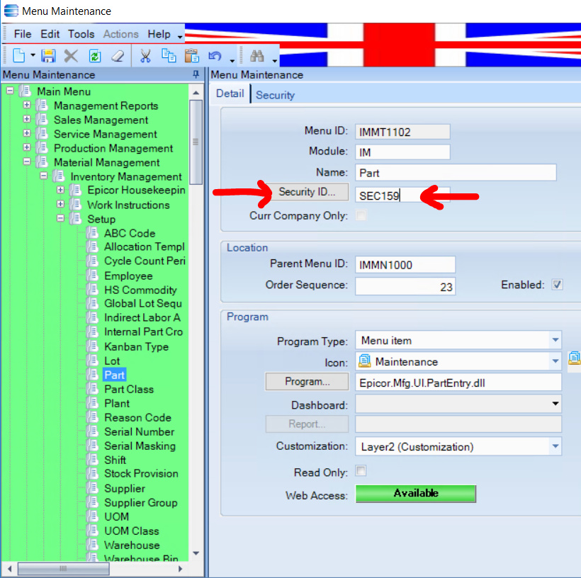

Now check the Menu items. They also have the security ID that links the groups.
Mark W.
Hi Mark,
Thanks for this,
So, if i understand correctly, this security ID in the screenshot sits somewhere behind 1 of the security groups?
That is correct. Click on the Security tab on that very screen and you will see it.

ahhhh i see the users / groups allowed and disallow section.

Be aware of the fact that each time Part appears in the Menu, it MIGHT have a different security ID attached to it - therefore, user might be blocked under Inventory Mgmt, but has access via User/Group under the Job Mgmt menu.

Have you tried in menu maintenance?
Look at the security behind the process.
