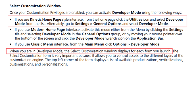

Some of our Kinetic screens do not auto-open up with the ‘Customization Window’ when Developer Mode is turned on. We can bring them up and make layer changes using Application Studio, but because we need event handling, we need to open up this window…
Anyone know why some screens work and some do not, and how to get the window to open up consistently?

So, some confusing semantics (thanks Epicor marketing…): Kinetic is the name for the ERP product now, but there are two UI views–Classic UI and Kinetic UI. You can run the Classic UI OR the Kinetic UI within the Kinetic ERP platform.
The window you’re talking about is only for the classic UI. Any customization changes will be done via the layer in Application Studio. Any event handling you did in the classic UI will need to be converted to events in App Studio if you’re now using the Kinetic UI; they will not fire if you create them in the classic UI, but are having your users open the screen in the Kinetic UI.
