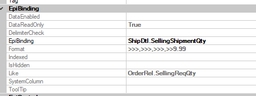

Customer Shipment Entry Customization on the field (Field help says the same thing):

As you can see, there is no SellingShipmentQty in here. There’s a few more fields that are like this, but the SellingShipmentQty field is the one I need

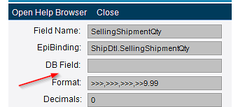

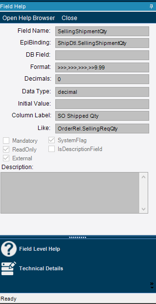

Here’s field help on the field:
It’s a calculated Field not a DB Field.
You could add the two SellingQty fields together, or link the OrderRel table in your BAQ and use the SellingReqQty.
