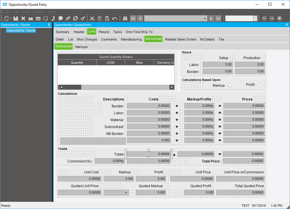

I am trying create a BAQ that will track all the jobs we are quoting and have quoted. I want to use the TotalCost field that populates on the Worksheet tab:

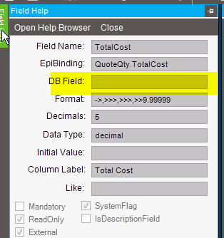

Looking at the EpiBinding, it looks like this field should be found in the QuoteQty table:
However, when I add the QuoteQty table to my BAQ, the TotalCost field is nowhere to be found. Does anyone have a reason for this? Is this field just hidden somewhere else, or am I unable to utilize this field for some reason?
I can probably figure out how get the total cost using calculated fields, but it seems like it would just be easier to use what is already there.
