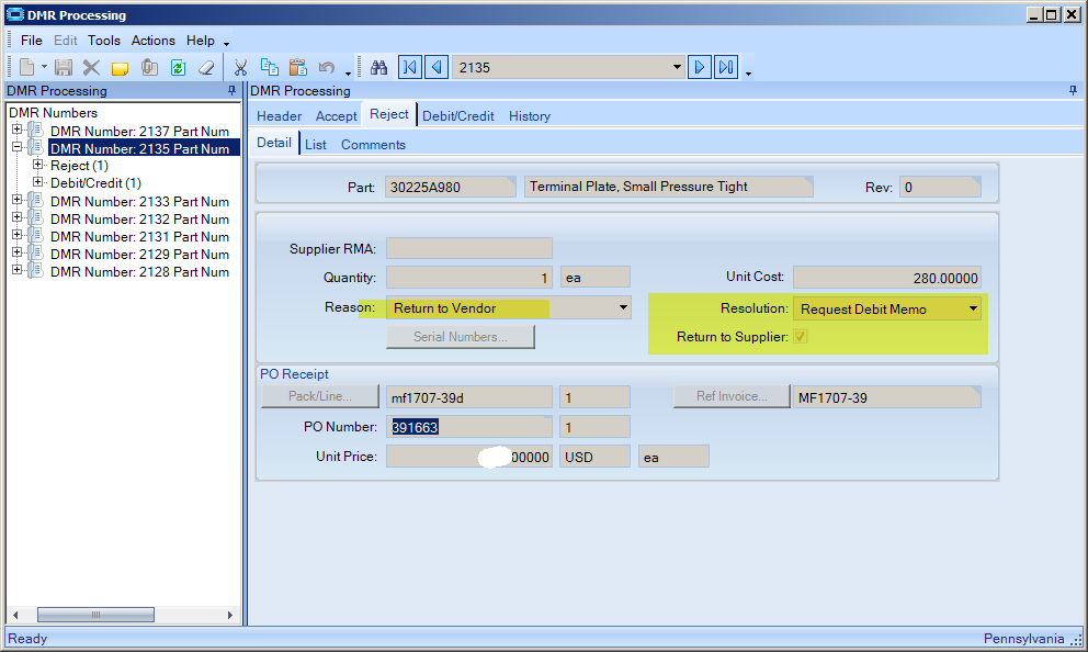

We do a discrepant material return (DMR) requesting AP to make a debit memo, per screenshot. Then we add a line to PO or create a new one to satisfy the purchasing need and receive that in when get it in.
Nancy

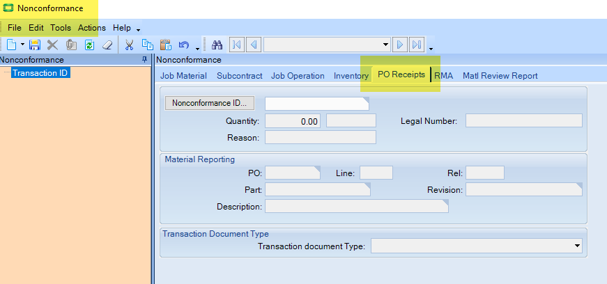

I think you need to do the nonconformance on PO receipt, rather than from inventory. Then inspection processing and DMR if return to vendor. Also, I think you can flag the receipt for inspection required and then that goes directly to inspection processing without nonconformance.
Nancy
Nancy
Thanks Nancy! Quality processing seems all over. I don’t see a PO receipt option
I’m still learning so I’m sure I do this somewhere else.
If the part is already received into inventory, then non conformance will be from inventory.

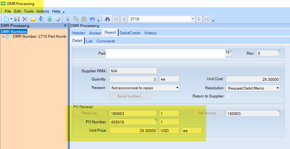

I should be able to do a miscellaneous shipment to send it to the supplier but how do I receive it back?
If I create another PO for the receipt there is no tie to the DMR unless I create a UD field for it. Is this correct?
The Epicor procedure is to the return the bad parts and create a Debit Memo. This is the last tie to the DMR.
If you want parts back, open a new line on the previous PO or a new one. Use the same cost as the previous PO. If you put zero and use Avg or Lot costing, you will mess up your inventory costs. If you need the DMR number on the PO/Line then put it in the comments.
