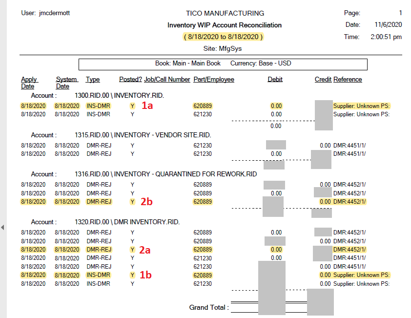

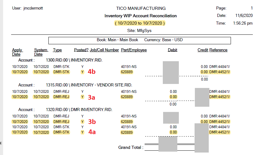

In real life it went like this. At 2b, it went into 1316 (sixteen) in August, and at 3a it comes out of 1315 (fifteen) in October.
1316 is the reason code account in this case (I triple checked) while 1315 is the company GL account for DMR Write Off.

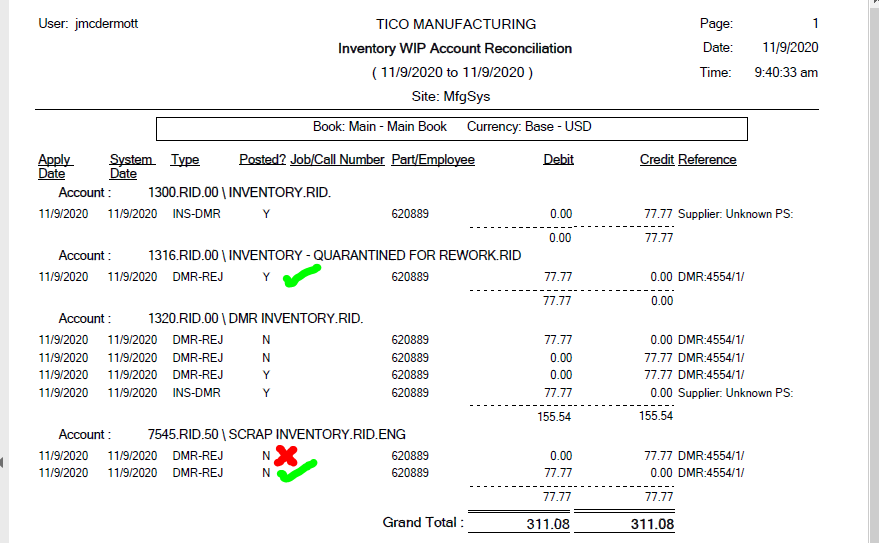

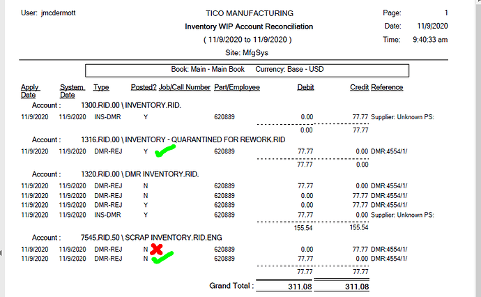

Confirmed.

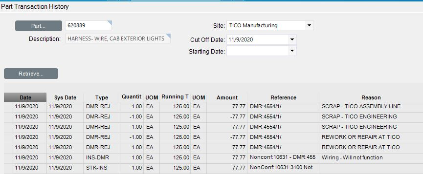

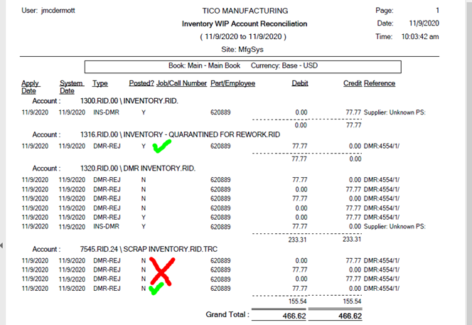

  1. First reject goes to debit 1316 (per reason code 91000)
  2. Run capture to lock in the account
  3. Delete the rejection
  4. Reject for a different reason
  5. Both transactions (since the capture) hit account 7545, per reason code 99350
    a. WRONG!
    b. Credit should hit 1316, per reason code 91000
    c. Debit should hit 7545, per reason code 99350
So it does all the math on the current reason code for action # 1, not the transaction reason code.

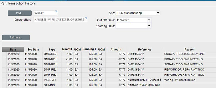

Case in point, I did the process again with no capture in between but I used a third different reason code, and ALL unposted transactions for that DMR action went to the account tied to the most recent reason code.
(It’s subtle - the third segment went from 24 to 50.)
But the History Tracker shows the different reasons.

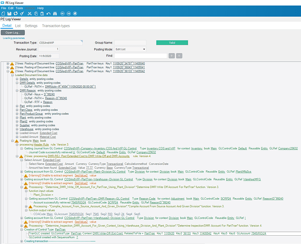

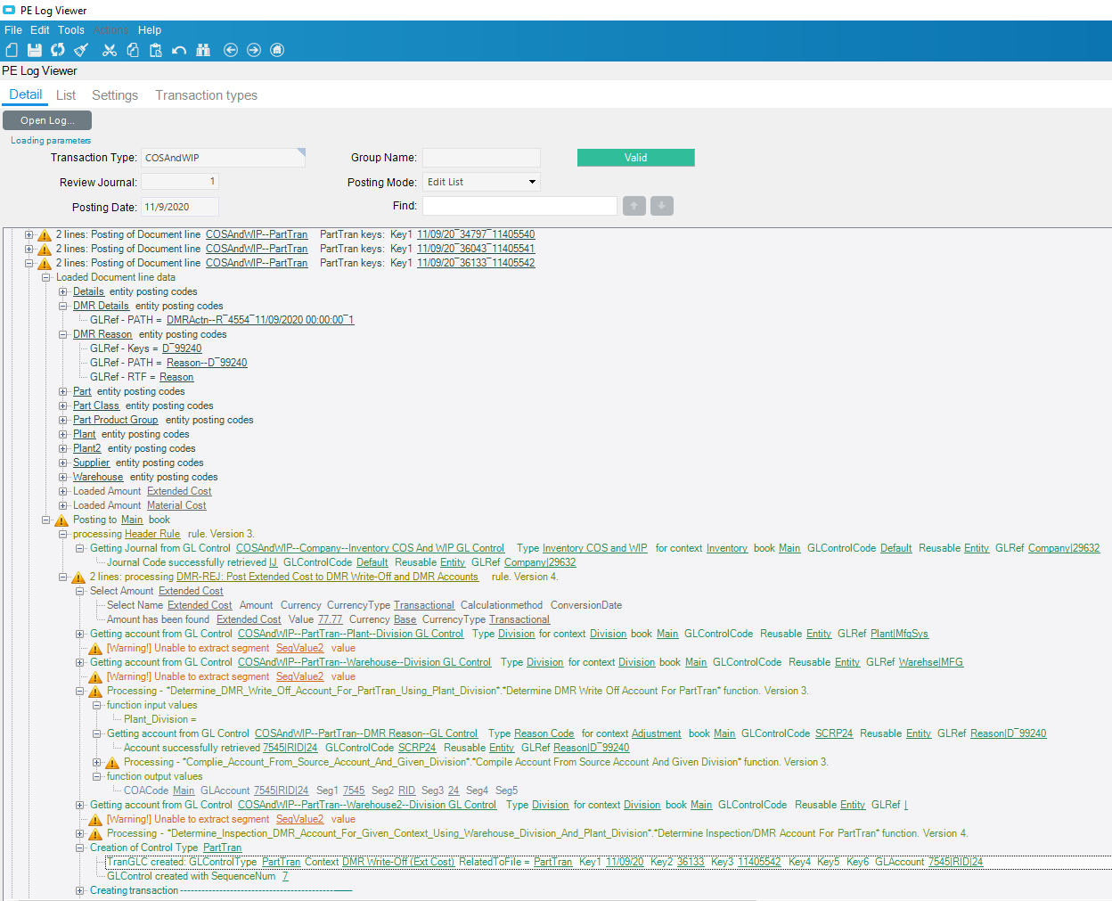

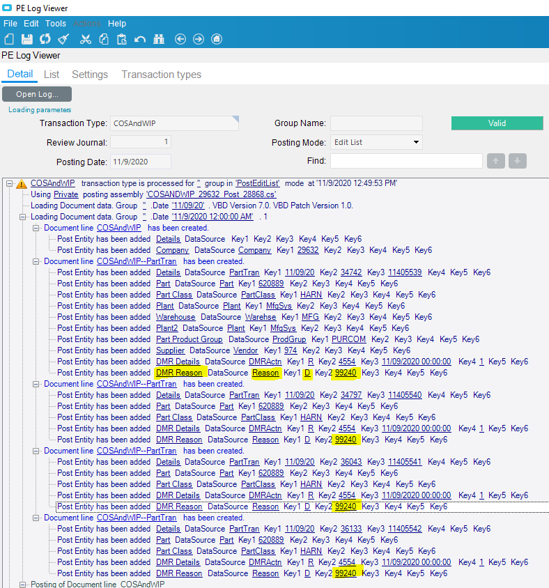

I can’t quite crack the logic of the posting engine.
I have proved by testing that it uses the DMR reason code rather than the PartTran reason code.

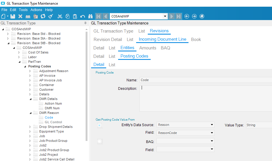

I opened PE Log viewer for my Inv-WIP report. It creates 4 “Part Entities” called DMR Reason and slaps all of them with the reason of 99240. (Wrong, there are 3 different ones…)
GL Transaction Type Maintenance only shows that it pulls from the “Reason” entity. Well, no kidding. But what’s the OTHER side of the join? I don’t think I can drill any further than that.

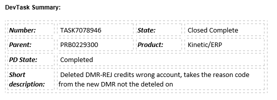

Development agreed this should be fixed. Problem PRB0229300 in EpicCare.
It’s funny, that was last week. Now my case is gone from EpicCare. But the PRB still exists, so at least there’s that.
This is a first for me, I think. They say this fix is complete now. It says “resolution” is 11.2.100. (Kinetic 2021.2, right?) I have not confirmed it myself, though.
