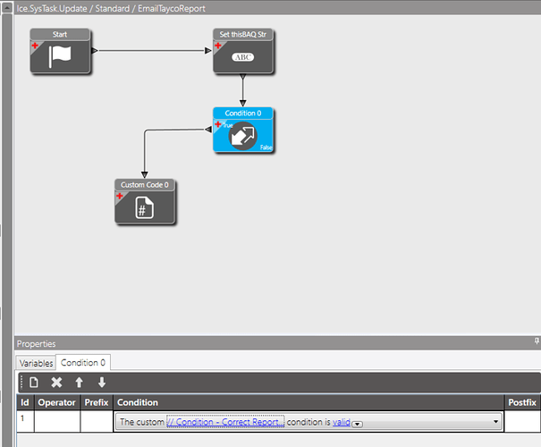

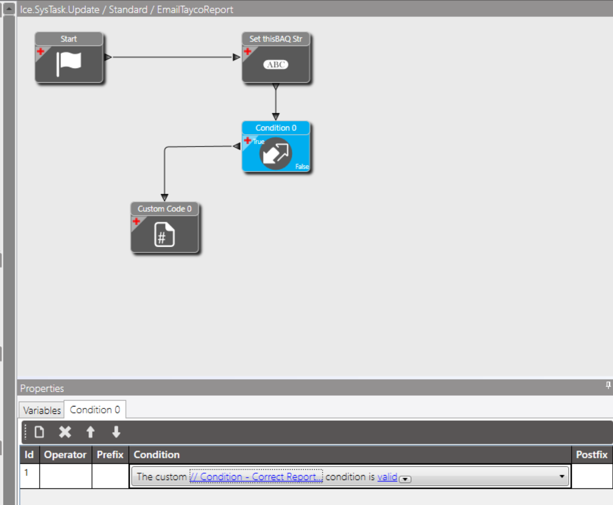

We don’t have Advanced Printing and Routing, so when I need this I use a Data Directive BPM. It can be done fairly easily, but there is probably an easier way to do it with Advance Printing and Routing. Here’s the data directive I use:
// Data Directive
// Table: SysTask
// Type: Standard
/*____________________________________________
    Widget Block: Condition 0
____________________________________________*/
// Condition - Correct Report
    foreach(var task in ttSysTask) {
        // Task is correct Report
        bool isMyReport = task.TaskDescription.ToLower().Contains( "sales order acknowledgment" );
        // Task completed Successfully
        bool taskSuccessful = task.TaskStatus == "COMPLETE";
        // Return true in loop so all may be checked
        if ( taskSuccessful && isMyReport )
            return true;
    return false;
// Data Directive
// Table: SysTask
// Type: Standard
    Widget Block: Custom Code 0
using ( var mailer = new Ice.Mail.SmtpMailer(this.Session) ) {
    using ( var message = new Ice.Mail.SmtpMail() ) {
        message.SetFrom("Kevin Veldman <myEmail@company.com>");
        message.SetTo("sendTo@company.com");
        message.SetCC( "copy1@company.com; copy2@company.com" );
        //message.SetBcc( "" );
        message.SetSubject( "Order Acknowledgment Printed" );
        message.SetBody( "A Sales Order Acknowledgment has been printed" );
        message.IsBodyHtml = false;
        mailer.Send( message );
