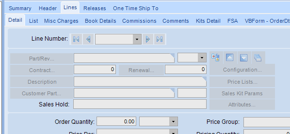

Separate sales description
Is there a way, without customization, within 10.2.400+ to have a different part description for sales as everyone else?
Sales Order Line = Part/Rev and Description (What you call it), Customer Part (What the customer calls it)
