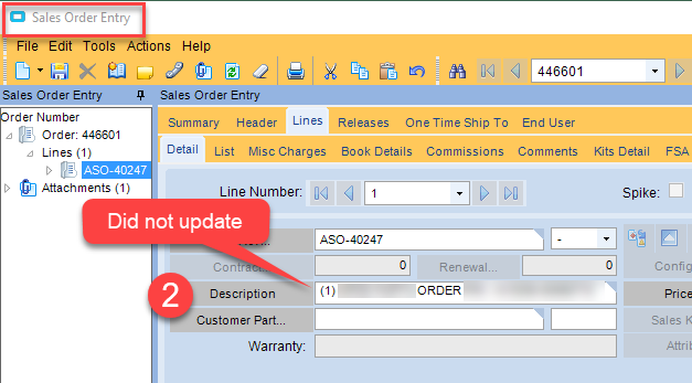

After entering an order in E10, the customer cancelled the order.

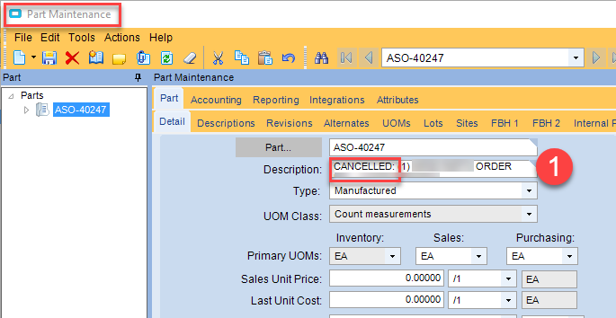

I revised the Part Description to include the word: “Cancelled:” in front of the original description. For example: Cancelled: (1) WIDGET. I go to the Sales Order AND Opportunity / Quote and refresh both to confirm the Line(s) > Detail > Description has updated…but sadly it doesn’t.
So, I have to update the description three times: 1) Part, 2) Sales Order Entry > Lines > Detail > Description, and 3) Opportunity / Quote Entry > Line > Detail > Description.
I’m curious, if the Part is edited, why doesn’t it change in open Sales Orders and Opportunity / Quotes?

Here’s a screenshot of Part Entry. So, it’s not blank.
Part.pdf (25.1 KB)

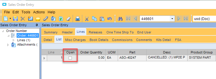

Close the line and release manually and it will be marked as void in the system. I’m not sure if that’s reflected on the sales order acknowledgement out of the box but with a quick edit to the report you could use that true false flag to put a giant void watermark over the whole line on the print out if you wanted. Or just a small one whatever floats your boat.
Are you already closing the lines and releases manually when a line is cancelled or are you leaving it open and just adding cancelled to the descriptions?
I’m not touching the Lines and Releases. I leave them open and just add “canceled” to the descriptions and add notes to Lines > Comments.
So if they are cancelled you need to go to the actions menu and close the line otherwise the demand will still exist in your system for that part. Closing a line manually marks it as voided.
Someone cancelled this whole order, ouch
I confirmed the SSRS native report for sales order ack removes the voided lines from the report. It’s not in the dataset either they are filtering it out at the report data portion. You would maybe need to figure out how to get it back in there if having it not show at all is an issue.
So, I closed the line manually. Here’s a screenshot showing OPEN as unchecked. I saw your last post and the VOID column is missing. I’ll reach out to IT and ask about it.
You said, “Someone cancelled this whole order, ouch.” Why is that problem? Once our accounting sends the last invoice, our orders are marked as shipped and closed.
When closing a line, any partial shipments against a line will result in a “CLOSED” status. If no activity has occurred for the line then it will result in a “VOID” status. They are two separate columns.
VoidLine = true then OpenLine = false
VoidLine = false then OrderLine could be True or False.
You can use the personalization feature to see the Void flag if that’s enabled for your user, but at the least the line shows not open.
