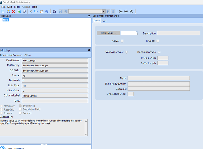

I have had a request from a customer for serial numbers to be attached with an 11 digit prefix, but currently Epicor is not allowing us to exceed 10. This will make up their item number of 6 digits followed by supplier ID (us) of 5 digits, and then a further 5 for the unique number to total 16 digits.
Is there a way to extend the allowance to enter into the prefix field as this is a system field? I may get around it by adding the last digit to the serial number mask but my concern is if we use the mask for another part in the future, we have to remember to set up the starting sequence again with that number.

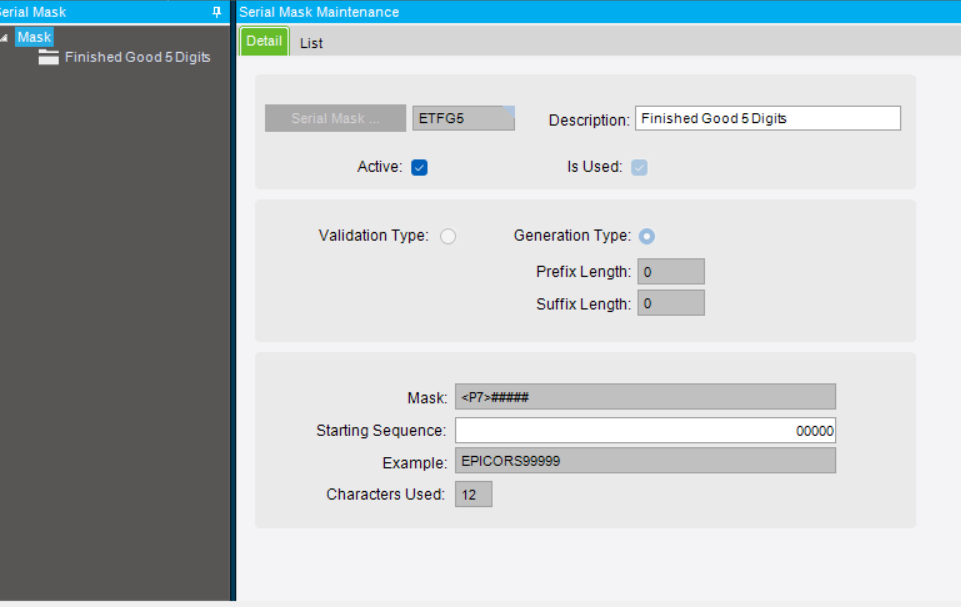

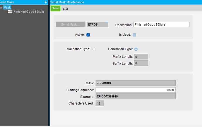

What is in your Mask field?
here is a 12 character SN

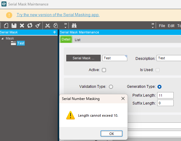

Just saw this. Looks like it is a restriction of the system.
Thanks for the input. I think this the best case for us to use the part number included in the serial number due to system limitations.
