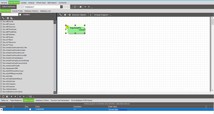

For more context, for example I tried this but it isn’t showing anything when I analyze:
Hard to tell what your query looks like from this.
If you start and just use the SerialNo table what is coming back?
When I am just using SerialNo as you suggested, it works.

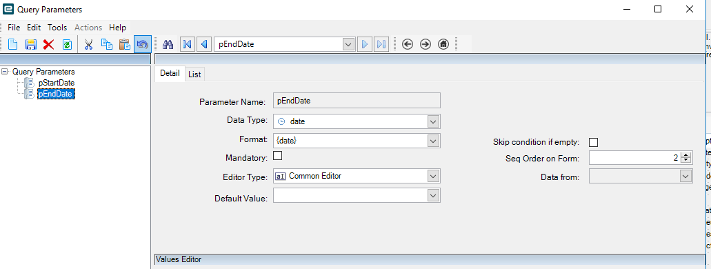

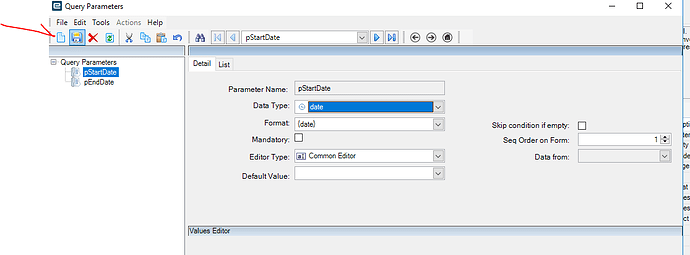

Here is the Parameter screen
click the new icon ( red Arrow)
fill in items as below
Click new again
Fill as below
Save and close screen

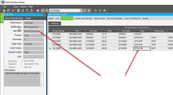

Most of the information you’re looking for lives in the SNTran table. There’s a transaction type specific to shipping tha should meet your needs. We do similar reporting and I get the information from that table. If I’m following what you’re looking for.
