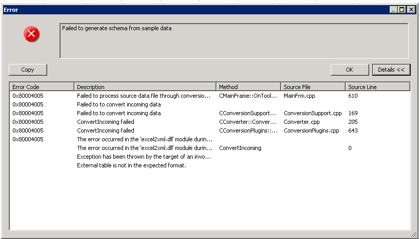

I get to the section where it tells me to Generate a Schema by pulling in the *.xlsx file I created and I end up with this error:
Did you user the conversion settings from the input channel for the conversion plugin? There are radio buttons on the previous screen. Typically I create an input channel with the correct conversion in it and create the schema from that. The other thing is I tend to earlier version excel files not the later. This might have changed in later versions of ESC. If that fails then try making the file into a delimited file with some sort of field delimiter. the default is comma, although depending on what data you are importing you may want to change that.

Using an older version of Excel worked.
