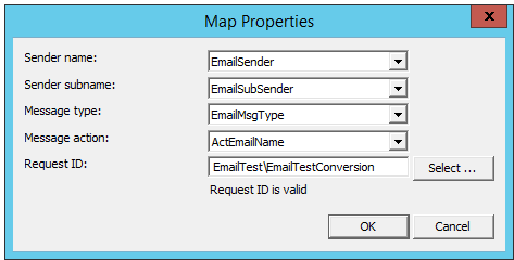

You need the input channel, a Message Type, an Action, a Message Map with Request ID and a Workflow. If those are all present and hooked up then at least something should happen and you should see things appear in Document Tracking.
We do have this working, but detailing all of it from scratch is more than I have time for. If you can say what yours looks like then maybe I can spot any differences.
input channel, a Message Type, an Action, a Message Map with Request ID and a Workflow. All are configured still not able to see any things in Document Tracking

Message Map Snap Shot

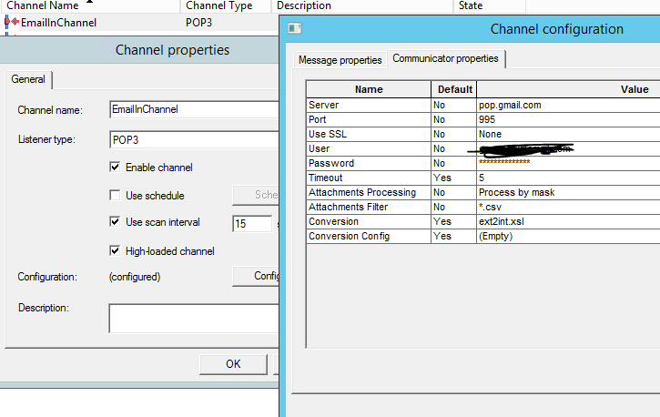

Input Channel Configuration
gmail IMAP Configuration

But the first thing I notice is that you’re using IMAP. As far as I know only POP3 will work.
Can you tell the configuration for POP3?
Ours is
Listener Type POP3
Scan Interval 15 seconds
High-loaded channel

If we try Pop3 Input Channel itselff getting failed when enabled.
I tried different Combination of Property Settings, for your information I am using gmail Server
