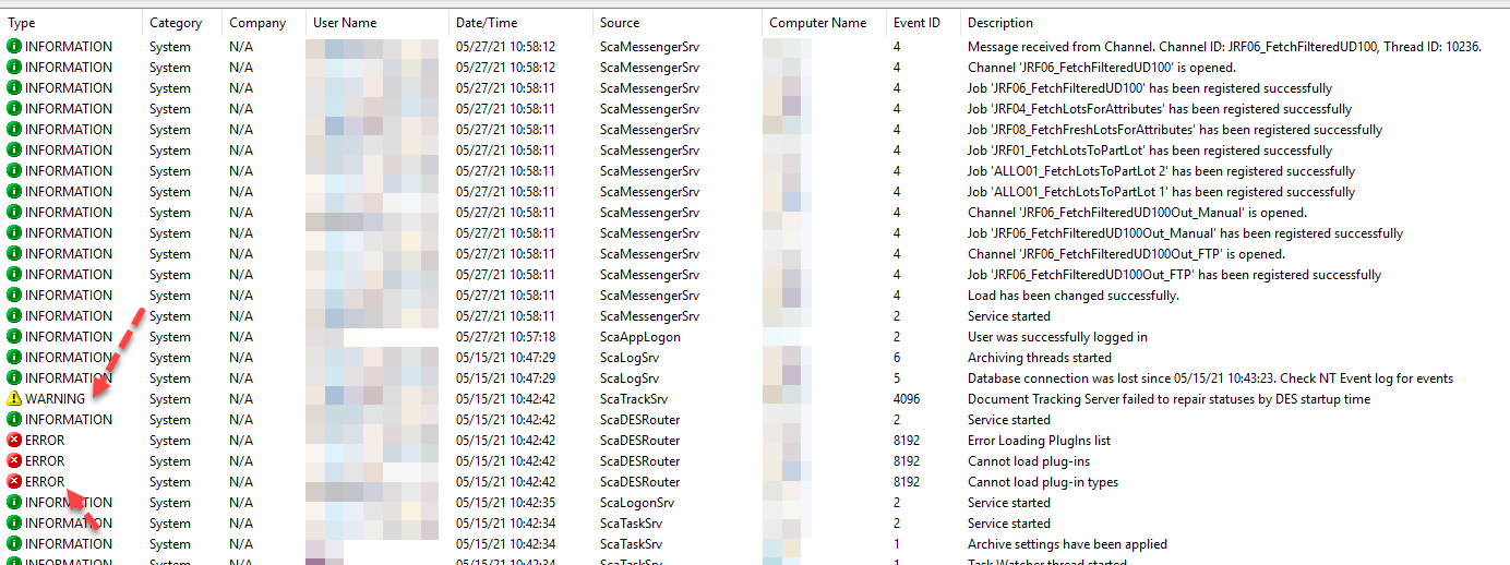

Are there any errors from ScaDESRouter in SC event log, before the issue with plugin started to occur?

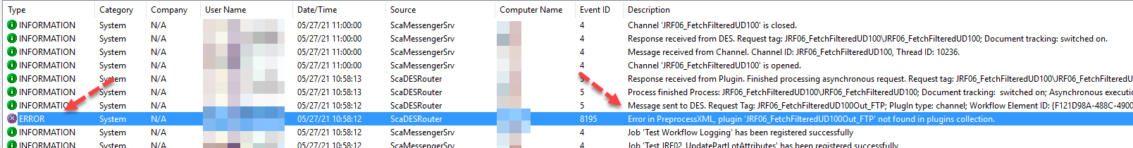

It looks like something occurred on 5-15 that caused a service ScaDESRouter to fail
Then, consistently after that, it looks like the error “Error in Preprocess XML…” occurred
Hi Aaron,
Yes, the errors about loading plugin types and list are most probably it.
Any details in the error messages of those?
I guess those might be related to MS SQL not being available, but not sure, as ScaLogonSrv waits for the database to become available before starting up all the other services including ScaDESRouter.
Document Tracking (ScaTrackSrv) could be another victim of SQL DB not being available (the Warning in your log), but that operation it was trying is a repair, it will be retried after the next restart of ScaDESRouter + ScaTrackSrv.
