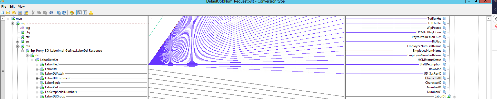

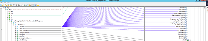

I think what is probably happening is these two new columns are showing up in your Service Connect Tables\Data Sets and they need to be mapped\linked throughout the workflow to keep their original data in tact.
So if these fields aren’t mapped throughout the workflow they lose their original data and get cleared out.
As in the example below, the Character01, 02 and Number01, 02 fields are not mapped so the data is not being transferred throughout the workflow and this will result in blank fields for whatever record(s) is being updated.
