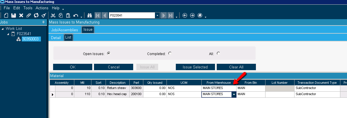

Set all From warehouses by BPM in mass issue from MFG screen
Need a help for setting all From warehouses when the From wharehouse changed in first row.
I have tried the BO massissueTomfg -> OnChangeWarehouse method, but it chages only 1 row at a time. i want to change all Warehouses to warehouse which was selected in 1st row. ?
Any suggestion ?

Thanks @Nancy,
I have just created a BPM on post processing directive on Erp.MassIssueToMfg.BuildMassIssueBrowse as you said,but i have choosen the other way I.e, displayed a BPM Data form Asking for From warehouse. User selects his priority and the selected warehouse is getting selected for all Open issues.
