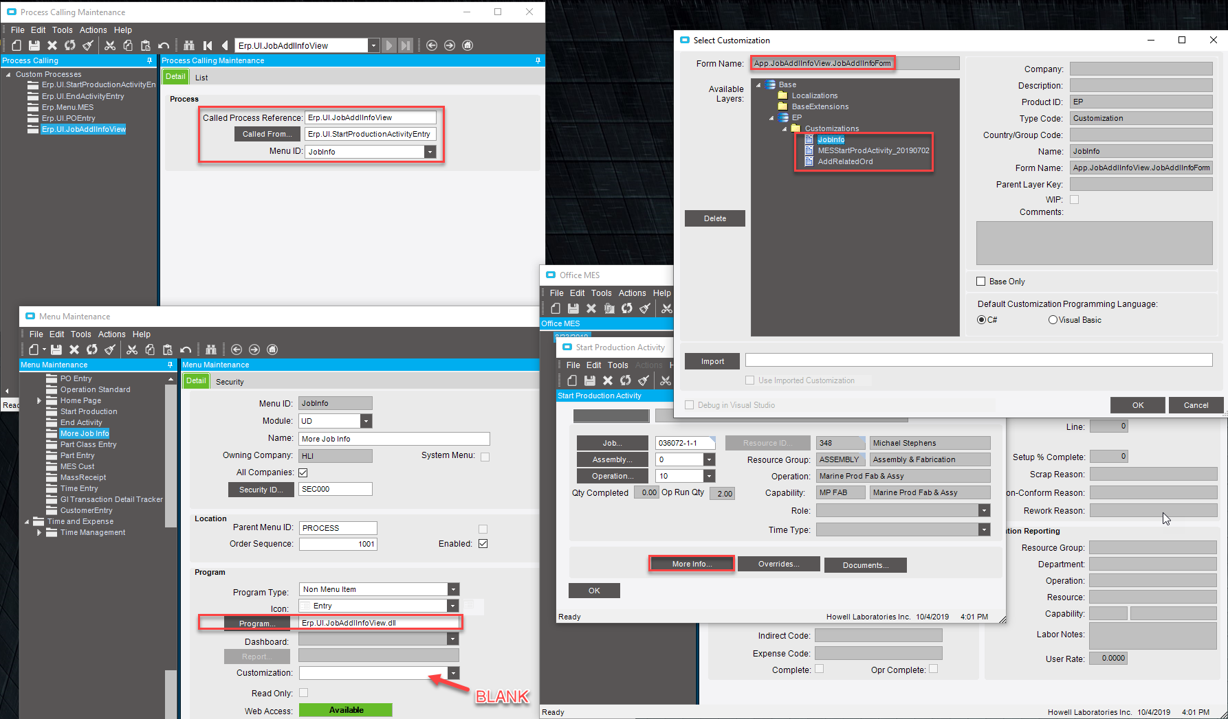

I’ve customized the More Info (Erp.UI.JobAddlInfoView.dll) screen from Start Production , to add an FKV field. The customization works when I launch it with Developer mode on. However, I can’t figure out how to set the customization as the default.
I’ve tried the following steps:
  1. Created a new Menu Item under Processes for More Job Info using Program Erp.UI.JobAddlInfoView.dll , but the Customization Pulldown is blank.
  2. Tired naming the Customization the same as the customization of the calling Program, no luck.
  3. Tired setting the customization to All Companies, no luck.
  4. Tried using Process Calling Maintenance, no luck.
I’m out of ideas…
Here’s the Process Calling info and a screenshot.
Process Key: Erp.UI.JobAddlInfoView
Calling App: Erp.UI.StartProductionActivityEntry
Menu ID: JobInfo

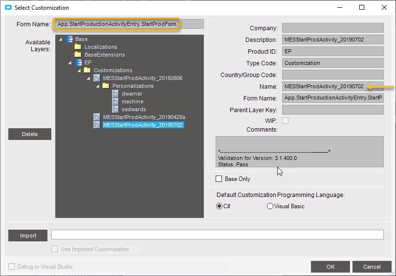

If you did it, can we just see screenshots of both the Start Activities Customization Selection Form and the Child forms (which you have above of course). Just for sanity :slight_smile: and clarity.
Also when you show up there that the Customization list is Blank. Wasn’t there an Epicor bug in a version where it didnt show Company Specific or maybe All Companies customizations… anyone remember @ckrusen @Banderson it might have been in Version: 10.2.200.xx which you may be using?
I quote @Rich
Menu Maintenance is broken for several DLLs where you cannot apply customization - versions 200.8 - 200.11. The issue has been fixed in 200.12 under ERPS-95829 and there is a HotFix available from support.
Some of the Epicor UI DLLs contain references for multiple different Forms. Some of those Forms are internally addressed (not available for adding to a menu) and some can be externally addressed as the Form to load when a menu option is selected. Since the Customizations are keyed by Form name and not DLL reference, Menu Maintenance needs to know which Forms are “Externally” available in order to show the Customizations in the dropdown Combo. A change made in 200.8 was designed to address a problem with displaying the appropriate customizations and while that update corrected the initial reported problem, it caused a new problem for a handful of other DLLs / Forms.

Thanks, @hkeric.wci. So, it looks like the root cause is an issue with the Menu Maintenance screen not showing the customization in the pull-down. Meaning when you apply the customization manual (through SQL) it works correctly, there is just no way to do that through the UI.
