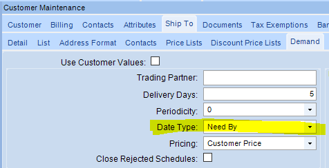

There may be another setting you need to look at, Date Type:
For us, we can change this between ‘Shipping’ and ‘Need By’
It seems to be the date you want it to watch for changes to, or, work from and apply logic to the other. I think thats what it does, I just know when I have it set to Need By it works.
