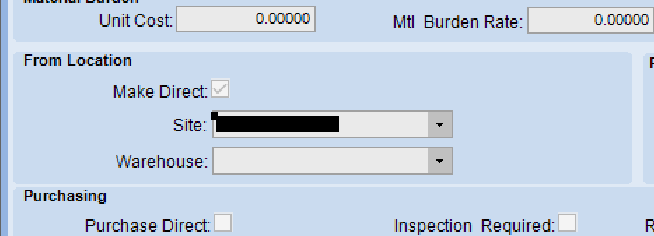

Yes, sort of. In the Site you finish/ship out of, the job has a material in it where the material has Make Direct checked. And you specify the other Site that will produce the material:
