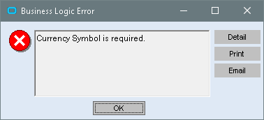

Thanks Calvin - Those steps definately worked as it added the blank space, however upon saving it still gave me the error “currency symbol is required”. Appreciate the help though

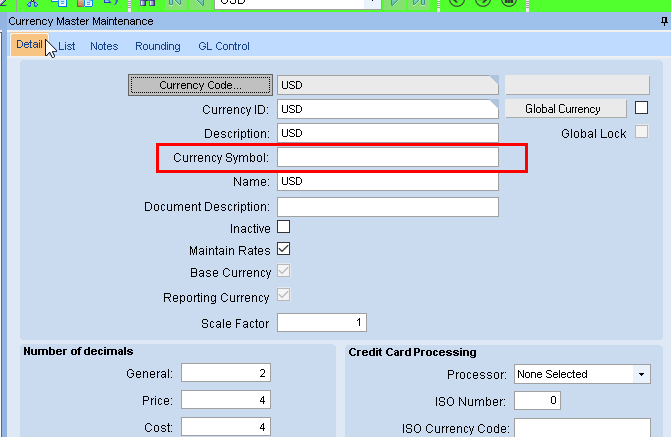

Hmmm… mine is blank.
Do you have more than one currency setup?
Just one currency for us - strange that yours is empty. My page looks exactly like yours but won’t let me clear out that $ from the currency symbol field.

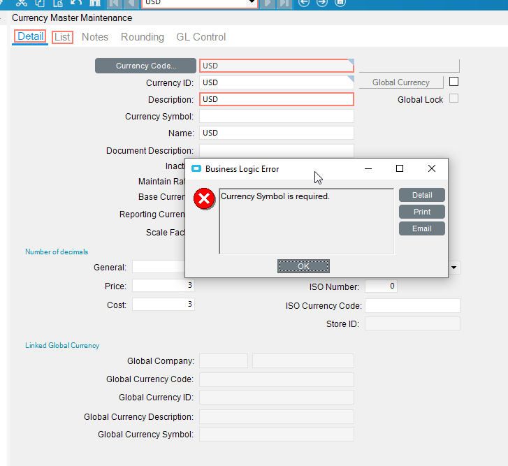

I’m on 10.2.300. Upgraded from 10.1.400 (which was a virgin install). So that was probably never set. I wonder if once it’s been set, it can’t be cleared.
Whoops …
I entered $ into the Symbol field and saved. Then I deleted it and now get:
But no big deal as this was in my test environment.

The error appears to happen during the BO Currency.OnChangeDecimals Which is odd that is even being called as the decimals haven’t changed.

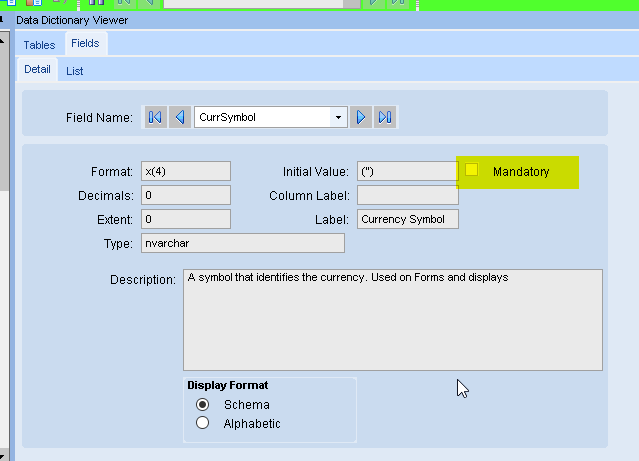

Currency Symbol is always required, always has been. But Epicor seems to have a bug when you create a new Company it will create it with Blank.

We ran with Blank for years just fine. It seems like its just used on Reports. But also seems Epicors intent was to make it mandatory, but they just have it in the wrong place.
