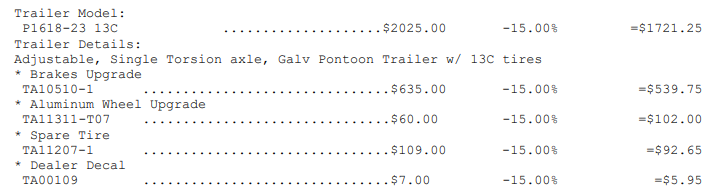

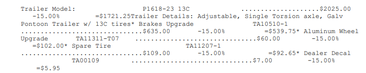

We have configured our Order Entry to display in the Line Description field on the acknowledgement form the details of the order. At times the display prints perfectly fine, but other times everything comes out jumbled up. Is there a fix for this?

We have created a lookup UD Method with the following code:
// Enter valid C# code. This method does not require a return value.
TrailerDesc = String.Empty;
TrailerDet = String.Empty;
var TrailerInfo = (from r in Db.UD32 where r.Company == Context.CompanyID
&& r.Key1 == Key1
&& r.Key2 == Key2
&& r.Key4 == Key4
select r).FirstOrDefault();
if(TrailerInfo != null)
if (Inputs.TrailerModelPrice.Value == Inputs.TrailerModelUnitPrice.Value)
TrailerDesc =
String.Format("{0,-30}\n\t{1,-25}","Trailer Model:", Inputs.TrailerModel.Value) +
String.Format("{0,20}{1,20}{2,20:C}","....................","....................","$"+Inputs.TrailerModelPrice.Value);
else
TrailerDesc =
String.Format("{0,20}{1,-10:C}{2,12}{3,18:C}","....................","$"+Inputs.TrailerModelUnitPrice.Value,"-"+Inputs.TADiscPercent.Value+"%","="+"$"+Inputs.TrailerModelPrice.Value);
TrailerDet =
"\n" + "Trailer Details: " + "\n" +
TrailerInfo.Character01;
Brakes = String.Empty;
ALWheel = String.Empty;
SpareTire = String.Empty;
STMount = String.Empty;
Decal = String.Empty;
Tritoon = String.Empty;
//Brake Lookup
if (Inputs.BrakeCheckBox.Value == true)
if (Inputs.BrakePrice.Value == Inputs.BrakeUnitPrice.Value)
Brakes = String.Format("\n{0,-30}\n\t{1,-25}","* Brakes Upgrade", Inputs.BrakePartNum.Value) +
String.Format("{0,20}{1,20}{2,20:C}","....................","....................",Inputs.BrakePrice.Value);
else
Brakes = String.Format("\n{0,-30}\n\t{1,-15}","* Brakes Upgrade", Inputs.BrakePartNum.Value) +
String.Format("{0,16}{1,15}{2,-10:C}{3,11}{4,18:C}","................","...............",Inputs.BrakeUnitPrice.Value,"-"+Inputs.TADiscPercent.Value+"%","="+"$"+Inputs.BrakePrice.Value);
else
Brakes = string.Empty;
//Alum Wheel Upgrade Lookup
if (Inputs.AlumUpgrd.Value == true
&& TrailerInfo.Character03 != "10E")
if (Inputs.WheelPrice.Value == Inputs.WheelUnitPrice.Value)
ALWheel = String.Format("\n{0,-30}\n\t{1,-25}","* Aluminum Wheel Upgrade", Inputs.AlumPartNum.Value) +
String.Format("{0,20}{1,20}{2,20:C}","....................","....................",Inputs.WheelPrice.Value);
else
ALWheel = String.Format("\n{0,-30}\n\t{1,-15}","* Aluminum Wheel Upgrade", Inputs.AlumPartNum.Value) +
String.Format("{0,16}{1,15}{2,-10:C}{3,11}{4,18:C}","................","...............",Inputs.WheelUnitPrice.Value,"-"+Inputs.TADiscPercent.Value+"%","="+"$"+Inputs.WheelPrice.Value);
else
ALWheel = string.Empty;
//Spare tire Lookup
if (Inputs.SpareTire.Value == true)
if (Inputs.SpareTirePrice.Value == Inputs.SpareTireUnitPrice.Value)
SpareTire = String.Format("\n{0,-30}\n\t{1,-25}","* Spare Tire", Inputs.SpareTirePartNum.Value) +
String.Format("{0,20}{1,20}{2,20:C}","....................","....................",Inputs.SpareTirePrice.Value);
else
SpareTire = String.Format("\n{0,-30}\n\t{1,-15}","* Spare Tire", Inputs.SpareTirePartNum.Value) +
String.Format("{0,16}{1,15}{2,-10:C}{3,11}{4,18:C}","................","...............",Inputs.SpareTireUnitPrice.Value,"-"+Inputs.TADiscPercent.Value+"%","="+"$"+Inputs.SpareTirePrice.Value);
else
SpareTire = string.Empty;
//Spare Tire Mount Lookup
if (Inputs.STMount.Value == true)
if (Inputs.STMountPrice.Value == Inputs.STMountUnitPrice.Value)
STMount = String.Format("\n{0,-30}\n\t{1,-25}","* Spare Tire Mount", Inputs.STMountPartNum.Value) +
String.Format("{0,20}{1,20}{2,20:C}","....................","....................",Inputs.STMountPrice.Value);
else
STMount = String.Format("\n{0,-30}\n\t{1,-15}","* Spare Tire Mount", Inputs.STMountPartNum.Value) +
String.Format("{0,16}{1,15}{2,-10:C}{3,11}{4,18:C}","................","...............",Inputs.STMountUnitPrice.Value,"-"+Inputs.TADiscPercent.Value+"%","="+"$"+Inputs.STMountPrice.Value);
else
STMount = string.Empty;
//Decal Lookup
if (Inputs.DecalOption.Value == "2")
if (Inputs.DecalPrice.Value == Inputs.DecalUnitPrice.Value)
Decal = String.Format("\n{0,-30}\n\t{1,-25}","* Dealer Decal", Inputs.DecalPartNum.Value) +
String.Format("{0,20}{1,20}{2,20:C}","....................","....................",Inputs.DecalPrice.Value);
else
Decal = String.Format("\n{0,-30}\n\t{1,-15}","* Dealer Decal", Inputs.DecalPartNum.Value) +
String.Format("{0,16}{1,15}{2,-10:C}{3,11}{4,18:C}","................","...............",Inputs.DecalUnitPrice.Value,"-"+Inputs.TADiscPercent.Value+"%","="+"$"+Inputs.DecalPrice.Value);
else
Decal = string.Empty;
//Tritoon Lookup
if (Inputs.TritoonUpgrd.Value == true)
if (Inputs.TritoonUpgrdPrice.Value == Inputs.TritoonUpgrdUnitPrice.Value)
Tritoon = String.Format("\n{0,-30}\n\t{1,-25}","* Tritoon", Inputs.TritoonPartNum.Value) +
String.Format("{0,20}{1,20}{2,20:C}","....................","....................",Inputs.TritoonUpgrdPrice.Value);
else
Tritoon = String.Format("\n{0,-30}\n\t{1,-15}","* Tritoon", Inputs.TritoonPartNum.Value) +
String.Format("{0,16}{1,15}{2,-10:C}{3,11}{4,18:C}","................","...............",Inputs.TritoonUpgrdUnitPrice.Value,"-"+Inputs.TADiscPercent.Value+"%","="+"$"+Inputs.TritoonUpgrdPrice.Value);
else
Tritoon = string.Empty;
