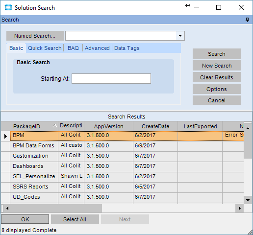

You wouldn’t happen to know if there’s a way to export the solutions you create? What I mean is when I create a new solution and save it, even though I can build that solution and export a CAB file to be installed in the other Epicor environments, the actual solution is only saved in the environment where I created it. Is there a way to export solutions (those that have been saved and show up when you search and load them)? It would be nice to at least be able to back up the list of solutions you create in case the database get’s whipped.

That will install all of the items in the solution package, but that solution won’t show up in the Solution Workbench like it does in the original environment where the package was created in.
It would be nice to be able to export the packages so you can import them into the other databases.
It would be more like a solution package import as opposed to a solution install. I imagine that Epicor would have to redefine some GUIDs in the solution package since they would be different on a different system.

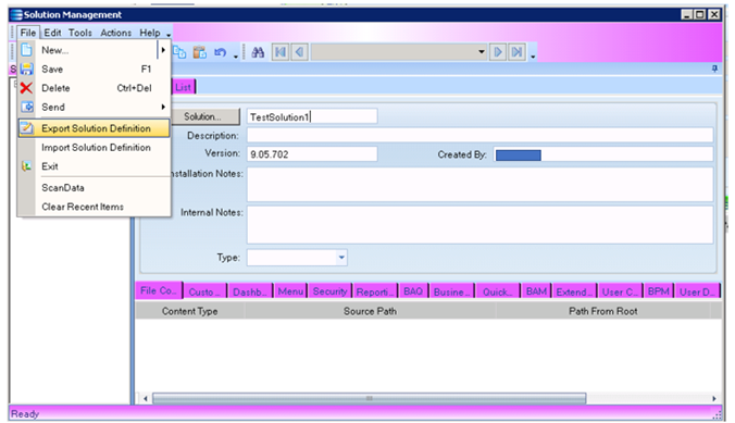

Back in E9 they had an actual File - Export Solution Definition option:
It would really be nice to have this functionality brought back into E10 cause I really don’t want to have to rebuild my Solution Setups/Definitions every time I bring in a newly migrated testing database. If anyone does figure out a way to get this working in E10 could you please let us know? Thank you! :slight_smile:
