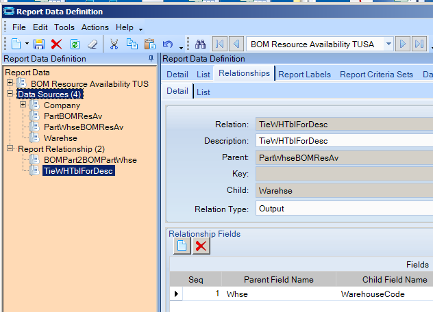

SO… I revised the RDD to add the warehouse table and tied it to the PartWhseBOMResAV data source per below. The relationship works because i have sent data out using warehouse address1 field and see it. Where my problem occurs is that I need the Description of the warehouse from the warehouse table.
No matter what I do, I cannot get this field into the downloaded rdl. I see the description field for the parts, but it will not give me the description for the warehouse. It is as if the RDD will not send out a field that is called the same thing as one in there for another data source.

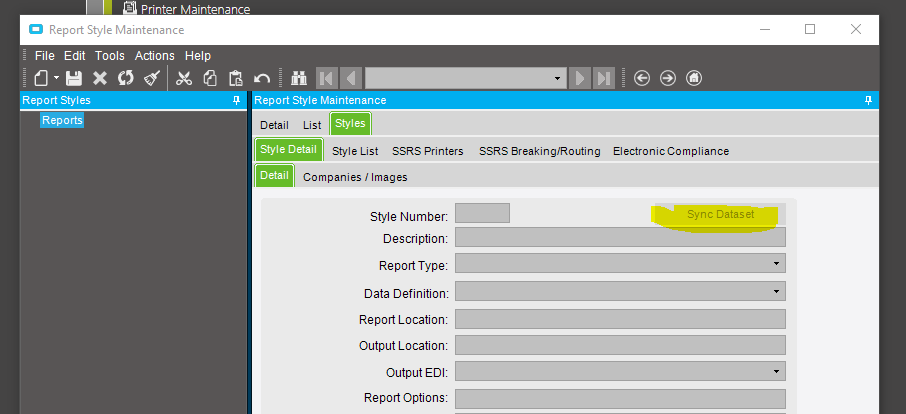

Under Resport Style did you click on Sync Dataset?
What is the SQL of the Query of the dataset? Do you see the field there?
Hi Kim,
Yes, I have checked sync dataset, so that’s probably not the culprit :frowning:

FWIW - Clicking on Data Sync is almost never a good idea. The dataset tree in SSRS builder will look entirely different after using the Data Sync.
You have to manually edit the dataset in the SSRS report. :frowning:

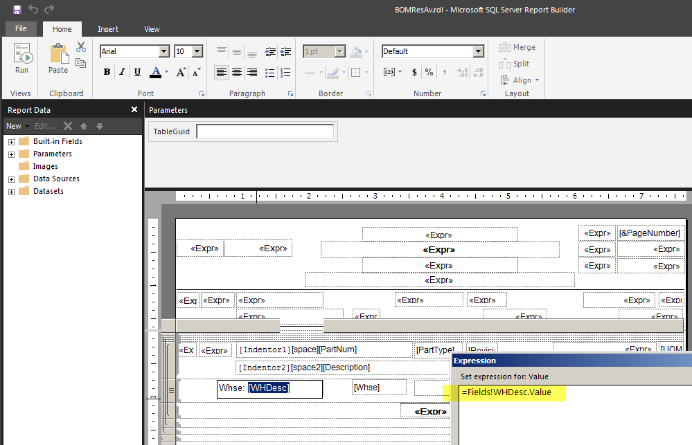

Yes (thank you too @ckrusen :)), I am trying to follow the instructions but the addition of the field chokes because it is the same name “description” as one in there already for the part, T1.
So I tried to give it an alias in the SQL T3.[Description] AS WHDesc. I see it in the list to add now and added it to the report. However, during print preview on the uploaded RDL, it doesn’t give me any data in the WHDesc field.
Thank you,
Nancy
What does your text field expression say and what row group is it in?
Hi Brad,
I’m not sure how to state what the “row group” is?
But here’s a screenshot of the design with the WHDesc field in there/expression.
Thank you!
Nancy
If you do this value instead does it still return? I am trying to figure out if this is an issue with your entire join or just this specific field.
Brad,
At first the addition of Add1 did not work, but I had seen it work playing with it yesterday, so looking further into that, I realized when I messed with the SQL I had gotten an extra space in here Parameters!TableGuid.Value + " T3 ON T2.[Whse] = T3.[WarehouseCode] before the T2. Yikes!
