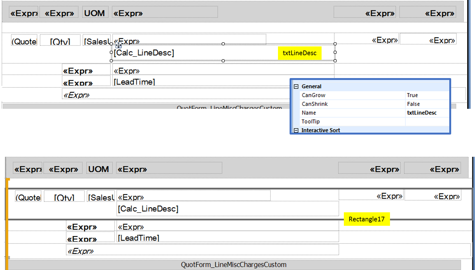

We have a custom version of the quote form that has the line description field inside Rectangle17. Same location as on the SSRS default version. So the value of txtLineDesc’s Parent property is Rectangle17.
Our line descriptions vary from 1 to 3 lines. We would like the space this field occupies to be as big as necessary, but no bigger. We have tried making the field size bigger and setting the Can Shrink property to TRUE; we have tried making the field size smaller and setting the Can Grow property to TRUE. Neither seems to work.
Is there something we are missing? I did not see Can Grow or Can Shrink properties on Rectangle17; is there some thing else that would affect the field properties?

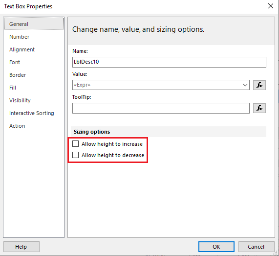

The right-click Properties menu options seem to be tied to the ones in View | Properties pane, so the checking the “Allow height to increase” checkbox sets the “Can Grow” property to TRUE.

Right click on the column you would like to Increase or Decrease. Select Properties. On the General tab:
Thanks. Did that, but it does not seem to work. Those sizing options are available for the textbox, but not for the rectangle or the tablix.

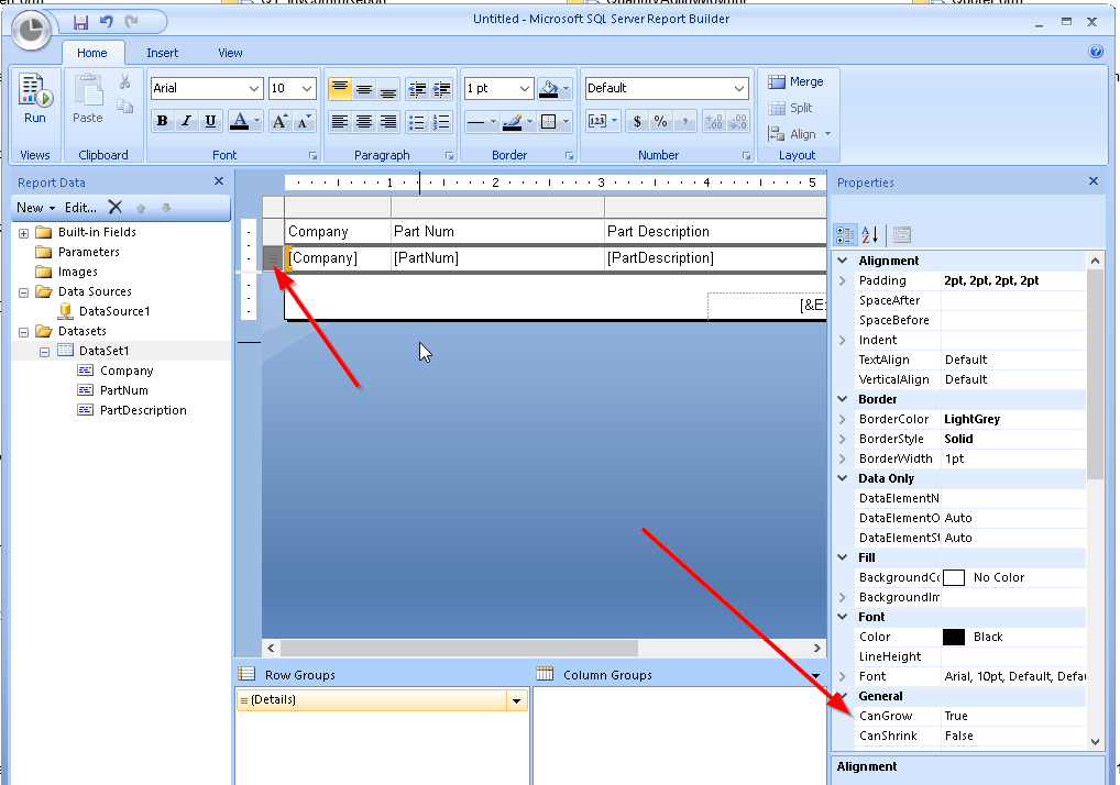

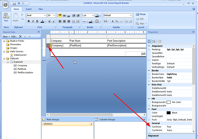

Rows of a tablix can be constricted too.
Select the row, then look for CanGrow in the properties pane.
EDIT
Correction. That property doesn’t really pertain to the row, but as a way to set all the objects in that row. Setting the Row’s CanGrow to FALSE, sets all the cell’s CanGrow property (in that row) to FALSE.

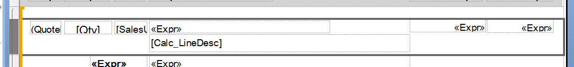

Thanks. When click in the left margin (or whatever is selected in your image), I get Rectangle 17, not the row of the tablix. The rectangle has a non-editable Location property of 0,0, so I don’t know how to get around it to the underlying tablix.
“Can grow” on all the fields in the rectangle would be fine. The description would be the only thing to have enough content to grow.
Did adjust the field slightly so there is no overlap, but still no multi-line description:
