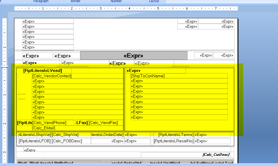

I assume you mean these areas of the PO Form
And sometimes there are hardly visible rows or elements. If You zoom in on the area highligthed above, you’ll see there are two tablix rows above the row that holds the addresses. And in the top one, there are two “hidden” fields (i’ve highlighted them yeallow and magenta)
So zoom in and see if there are any "hidden elements that prevent you from shrinking the conatiner’s size.

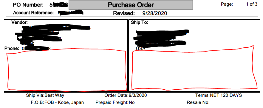

So, I have been using tab to move through all the elements (this can help to find very small elements), but I am still struggling on how to Shrink the Address boxes on the POForm. I have shortened the long skinny text boxes and made every text box Can Shrink = True and made the label boxes hidden if the calculated field is null.
I want the address row to shrink up, you can see how high the Phone number moved up.
What else am I missing?

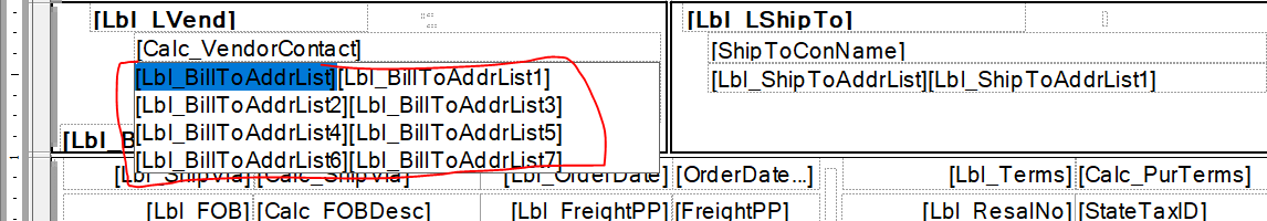

@mark.yates thanks for the tip. So I wanted to share how I ended up shrinking the huge address boxes on my copy of the PO Form. I am certain there are many ways to do this, so if you have a better more efficient way, I would love to hear it.
So the original form has 8 address lines for both the vendor and the ship to (but as @mark.yates and @ckrusen mentioned, this is a single address field separated with multiple ‘~’ that indicate a line break). In report builder, I could not make the Tablix Row that contains all the individual address text boxes any shorter due to all the space the individual text boxes require (even after making those text boxes can shrink, still left a lot of unnecessary white space). So I left the Calc_VendorContact and ShipToConName text boxes alone (other than to allow them to Can Shrink).
The text boxes directly below those mentioned above (Lbl_BillToAddrList and Lbl_ShipToAddrList), I crammed all the text fields into one text box.
I was careful not to hit enter between adding these fields (just pasting one directly after the previous within the same text box), because if you do hit enter, you will still get all the blank lines showing up because you just added carriage returns/line feeds. So I had to insert the carriage return/line feeds into the Value expression of the individual text fields.
This is the formula I used for Lbl_BillToAddrList (no carriage return/line feed on this first one):
=IIF(split(Fields!Calc_BillToAddrList.Value,"~")(0).ToString() = "","", split(Fields!Calc_BillToAddrList.Value,"~")(0).ToString())
For Lbl_BillToAddrList1 (and all the way up to 7) I used the following formula format (containing the vbcrlf carriage return/line feed):
=IIF(split(Fields!Calc_BillToAddrList.Value, "~")(1).ToString = "", "", Microsoft.VisualBasic.Constants.vbcrlf + split(Fields!Calc_BillToAddrList.Value, "~")(1).ToString)

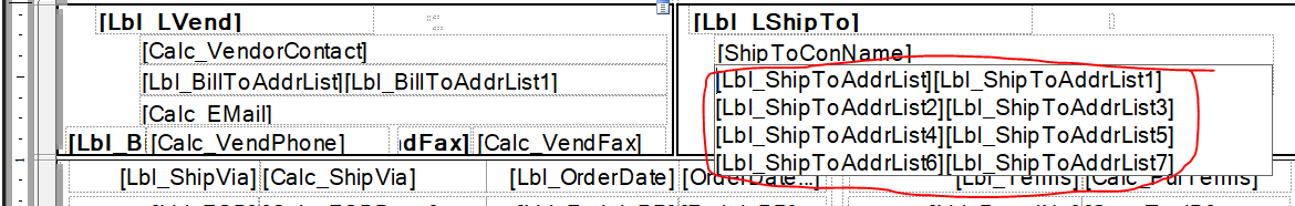

The standard form has some nice functionality on the Ship to side (for multiple ship to address or for drop ship release) and I did not want to lose that functionality (but I did want to lose all that excess white space in the address box).
So the Value expression for Lbl_ShipToAddrList (no carriage return/line feed on this first one):
=iif(Fields!Calc_MultiShiptoAddresses.Value = True Or Fields!Calc_ExistingDropShipReleases.Value = True, "{" & chr(160) + Fields!RptLiteralsLSeeBelow.Value + chr(160) & "}", IIF(split(Fields!Calc_ShipToAddrList.Value, "~")(0).ToString = "", "", split(Fields!Calc_ShipToAddrList.Value, "~")(0).ToString))
For Lbl_ShipToAddrList1 (and all the way up to 7) I used the following formula format (containing the vbcrlf carriage return/line feed):
=iif(Fields!Calc_MultiShiptoAddresses.Value = True Or Fields!Calc_ExistingDropShipReleases.Value = True, "", IIF(split(Fields!Calc_ShipToAddrList.Value, "~")(1).ToString = "", "", Microsoft.VisualBasic.Constants.vbcrlf + split(Fields!Calc_ShipToAddrList.Value, "~")(1).ToString))
This resulted in a more compact address (but capable of growing) with limited white space.

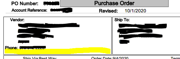

Some oddities I have seen that I do not know how to resolve.

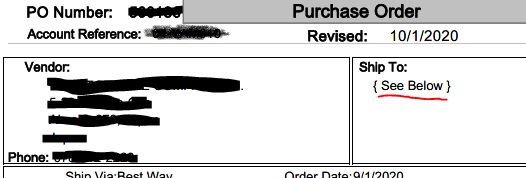

Things print great when the PO is a drop ship (no extra space below the Vendor phone number):
POAddress6
But when it is a standard shipment, it shows an extra line space below the phone number (and I cannot figure out why).
