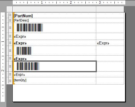

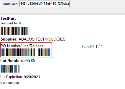

I’m afraid I already know the answer, but is it possible to tighten up the spacing between rows? No matter what I do with row height or cell padding, it doesn’t seem to matter, this is as tight as the rows will go. I’d like to remove white space where the red lines are as I’m working with a small label and I’m running out of real estate.

Can you share a screenshot of the row groupings in your designer? This will help us understand what might be causing some additional space.

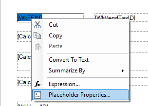

As for the bolding, you should be able to highlight the expression on the design surface and right click > placholder properties.
Click the radio button to allow HTML tag interpretation.
You can then include tags apart of your expressions and it will be bolded. <b></b>
Thanks, Aaron…I had tried that, but not with the ‘render as HTML’, which I’m not seeing anywhere.
Thanks, Chance, that was the missing link!
Ok, for the row height, no groupings at this point, just details.

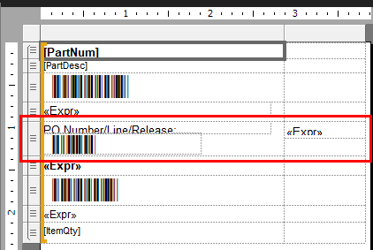

If you are looking for granular control of field placement, try putting a rectangle inside of your cell. Then add a text box. This will allow you to control where you want your field inside the cell pixel by pixel. This is how Epicor designs their base forms when things don’t need to export cleanly to excel.
Multiple rectangles inside of a cell, along with the padding change, has me close enough to move on to the next one.

Care to share a screenshot for others that come along looking for how you got the desired result? Want to see the difference in the design view.
I can do that…
I was trying to stick with 1:1 row/field as I don’t like the tedious nature of fighting their text boxes and rectangles, but as we saw, that wasn’t working. So where I need tight spacing, I’ll have to add multiple fields per row, remove the padding from each field and basically overlap them in designer…even this doesn’t get them as close as desired(red box), but my options are few and it’s better than the spacing between rows (green box).
