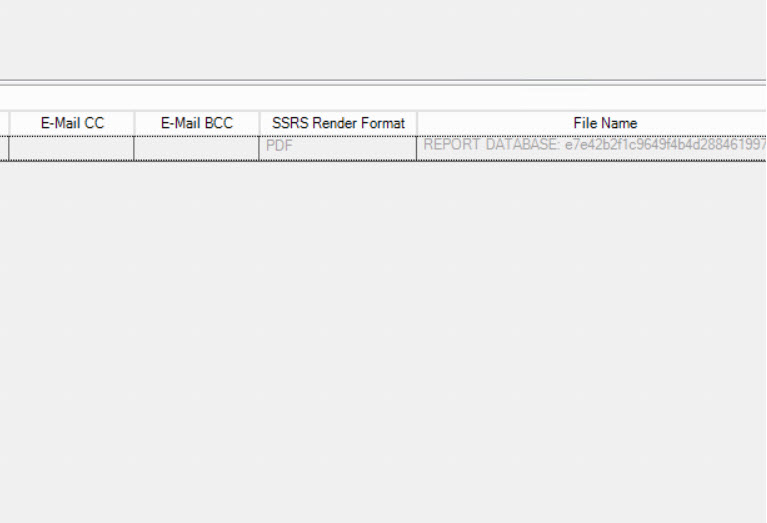

When I capture the TableGuid in the Filename field, it stay there for a 1 minute then disappears(??):
So, when I paste into the RDL to preview the report it says “invalid object name”.
You need to set your archive period on your report printing to a week or a month or something. Epicor went a bit over-board when fixing a bug which used to let it hang around for a while… not they eat it almost immediately.
Thank you so much, that was it!
Do you know if you if there is a configuration setting to make “Archive Period: 0 Days” to something more useful so it does not need to be changed on every single run?
