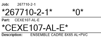

I am currently installing a test environment of 10.2.400. When printing the Job Traveller from Epicor Interface, I do not get the Bar Codes to print properly:
When running that same report from Visual Studio, I get the proper display for the bar codes.
Everything is fine when I generate the report directly from SSRS on client computer, SQL Server or APP server.
I installed the DWBAR39 font on Client computer, SQL computer and APP computer and rebooted everything 2 times.
Any thoughts as to why the report shows the proper barcodes from SSRS and Visual Studio but not from within Epicor interface ?
