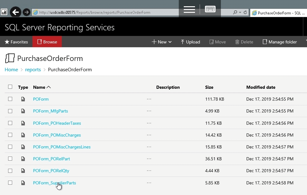

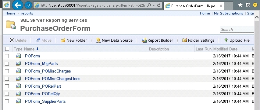

Are you sure that the name of the subreport is POForm-PORelQty? out of the box the name does not have POForm, it is just called PORelQty? Although it should not matter, I am just raising the possibility that this subreport has been modified.
Also, is the dataset in the subreport pointing to the correct database?.
Can you post the full error message?
Here are screen shots of the “out-of-the-box” files for the PurchaseOrderForm report. The first is from 10.1.400.23
And the following is from 10.2.300.23
Did you compare the RDD between the two versions?
