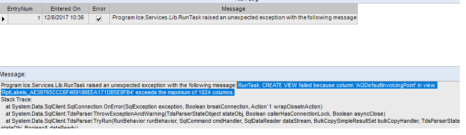

Currently I have built a test environment that replicates my production server that is currently version 10.400.16. In the hopes of upgrading to 10.1.600.13. With that being said I was able to upgrade the test server and users have been able to login in and test for awhile now. But one of the issues from the upgrade that has been leaving me stumped on how to resolve it. Is that when users navigate to “invoice entry” and select a custom report style, and select to print the custom invoice. The custom report errors out as so:

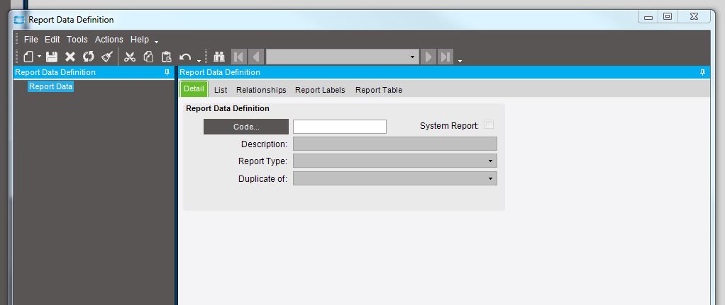

From the highlighted error message from the system monitor, this tells me that your datasets have too many columns coming back. Go into the RDD and hide any columns or labels that you don’t need.

I agree with Aaron. Go into the Report Data Definition and uncheck unneeded columns.

Tyler, it may be an exact copy from production ( 10.1.400 ), but the data definitions were completely redesigned in 10.1.600, so while it may not be an issue for you now, it will definitely be one in 10.1.600 (as you’re experiencing).
@hmwillett Thanks, I will take a look at the RDD and make a few changes.
Tyler, I spent a lot of time in the DD unchecking unneeded columns, trying to get them to work in SSRS without error; I did not have much success. After eliminating the max 1024 column message, I would get an object reference error. There were too many changes between forms to try to fix them, I ended up rebuilding them from the system forms. For example, we have many changes in the ARForm, Epicor eliminated half of the .rdl’s associated with the Invoice; datasets were also named differently. You’re time will be better spent redoing the forms with your changes.
