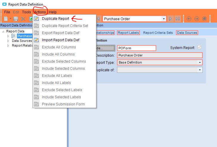

Find the name of the Data definition under report style
Then go to Report Data Definition, pull up that definition, then Actions, Duplicate Report.
Then make sure you change the Data Definition on your custom report style to match the name of your duplicated report.
