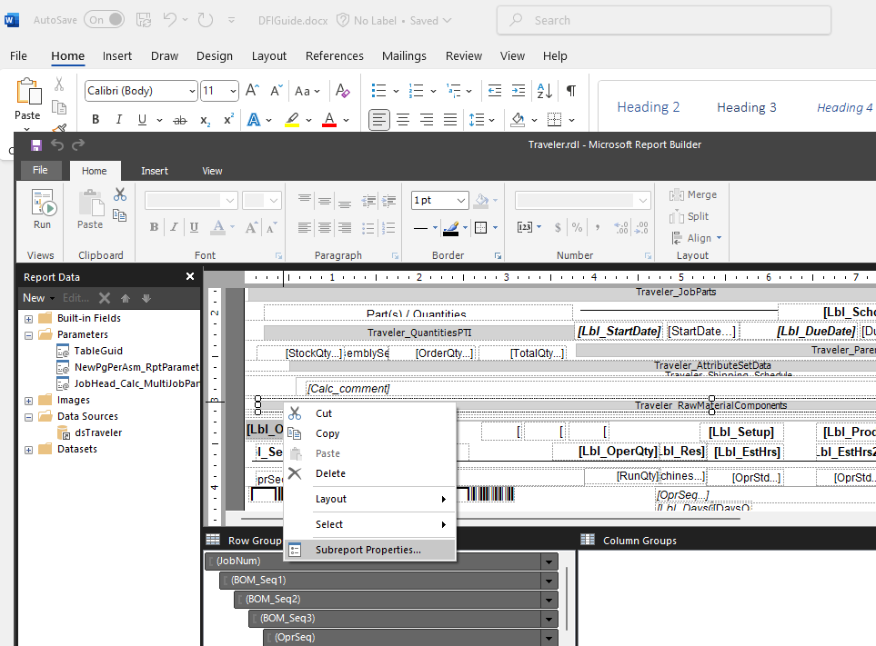

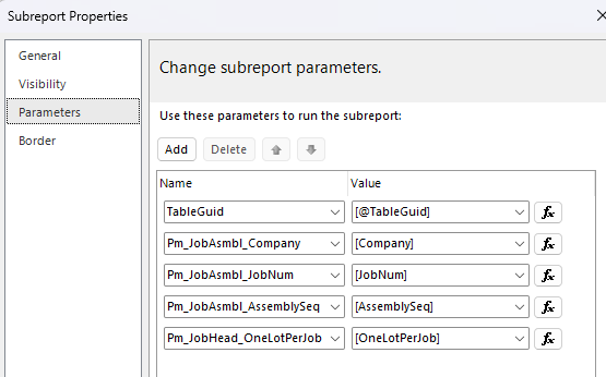

The Data Source should be the same but they each can have it own main SQL statement. In the Job Traveler, these are the parameters to pass information down to the Raw Materia Components sub report:
And these are the parameters passed to the report:

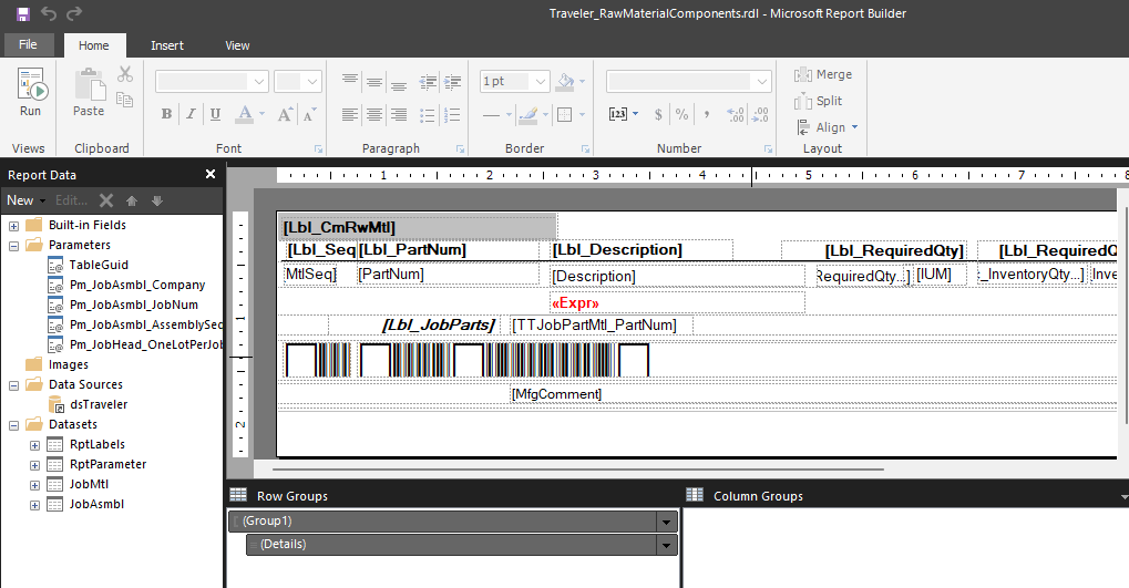

On the sub report, here’s where the parameters are received from the main report. You can also see the Data Source is the same but the sub report includes JobMtl where the main report does not.

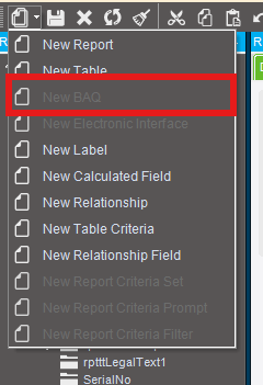

yeah, @ToryD , not yet… we can’t add a BAQ to a schema report yet. See picture below, I’m trying to add a custom BAQ as a dataset to the packslip report and it’s greyed out.
