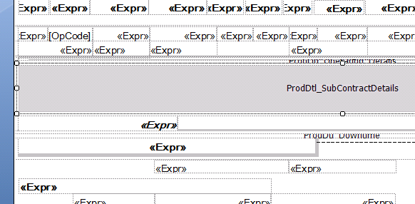

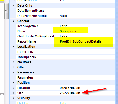

Found it. Use the zoom tool to zoom in and select the skinny rows, looking at the props pane to show which you’ve selected.
Here it is after I expanded it’s height
It is two rows above the row with Calc_SerialNoList
I made the background color of the row yellow in this pict:

I am now a little confused, looking at your example I found where theProdDtl_SubcontractDetails sub report should be located in the report.
zooming out the area to the max I found the line I was looking for but in my report it is not a subreport it is a rectangle.
It has ProdDtl_SubContractDetails inside a rectangle box. in the rectangle properties there is nothing that would allow me to change the link
to my Customized ProdDtl_SubContractDetails sub report.

I went back and had trouble finding it again, but eventually did.
I think it’s really hard to find because the height is set to 0
You have to click right on the line that would be the top of that row.
Edit: I only highlighted the [Calc_Serial…] row as a reference
