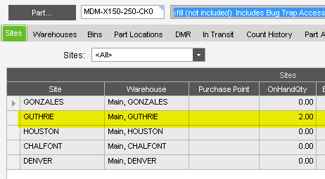

I’ve got a part in inventory that won’t show up on the Stock Status Report.
Well, it does show up. But its QOH is zero, while the Part Tracker, PartTran History and PartBin table shows a qty of 2.
Part Tracker
Part Tran History
PartBin query
When I run the SSR (limiting it to just the part in question), I get “No Records”. So I uncheck the “Exclude Parts with Zero Qty’s”, and it runs. But shows:

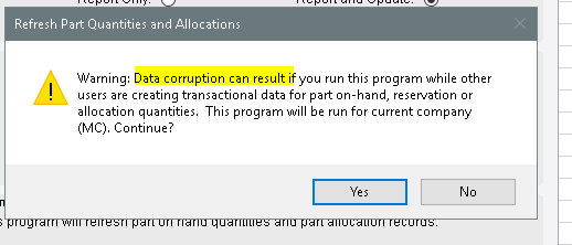

I was about to run it in Report and Update mode, but get the following.
So I’ll wait until after hours…
