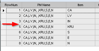

You’ll need to do something special to include “empty” sub strings (see the example below doesn’t include the field consisting of just the space)
This yields:
edit
It will give all 100 rows (or however many your Top xxx was in that first subquery). Use a subquery-criteria to filter out the blank rows.

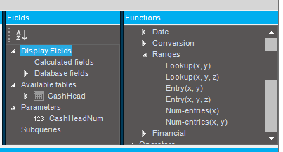

Nope. Standard Epicor. You’ll see it in the Ranges section:
It’s a hold over from Progress/Vantage.
These are custom functions that you can see in Programmability - Functions folders in SSMS.
