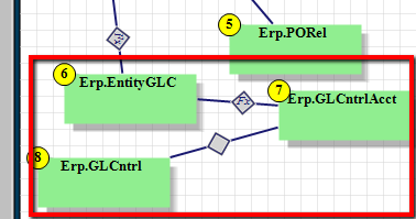

I would only use it for those “repeatable things I do”… I think I have this LOGIC Here atleast 18 times repeated throughout BAQs to get a single column, sometimes even Sub-Select Query:
2018-06-28_1836
Even for ParCost going to the Plant figuring out my default Part Cost ID over and over again :slight_smile:
