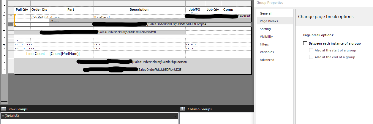

I have a report where the subquery is supposed to put the kit parts under the parent part, but instead it’s putting on a separate page. The subreport doesn’t have any page breaks.
Is the kit part number and the subreport in the same row group?
Is there a page break on any of the groups?
It is in the row right beneath it. There are no page breaks in the groupings. The idea is, if the part above is a parent part, show the kit info underneath it.
Yes, but just because it is the row underneath does not mean that it is in the same row grouping
One thing that you can try is clicking on the Details under Row Groups and then setting the KeepTogether to True.
