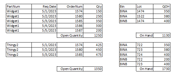

I’m looking to take the scheduled shipments report, group it by customer and part number. That parts pretty simple. I’ve got a request to also see info on the quantities on hand. I could build this as a linked subreport and have that be at the part number totals. However, I’d like to have this side by side with the order release data, kind of like this:
Obviously, there are times when I’ll have a lot more open orders (the left side) than bin/lot information (right side). And times where it’s switched.
Is it possible to do this with SSRS?
Sure, you just need to use multiple Tablixes. Might be tough to get the totals to line up though.
Yeah, I didn’t know if there was a way to link data in one tablix to another. Kind of like you’d do with a subreport. I could do the subreport, but not sure if I can have that span across multiple rows within the Part Number grouping.
I think I’m at the point of realizing it likely COULD be done, but would probably involve a whole lot more effort than it’s worth.
