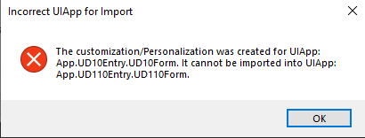

We need to switch a customization from UD10 to UD110/110A and don’t want to have to recreate the form with all the controls (there is a bunch). Has anyone successfully accomplished this? I tried importing the UD10 Form customization but it I get this error:
You might be able to do this via the code XML, but you’d need to be very careful doing so. I assume many of those controls are bound to the old data view as well, which will need to be changed in the XML
If you export the customization to an XML file, do a find and replace of “UD10” with “UD110” in every instance, and then reimport… it might work. Have not tried it myself though.
