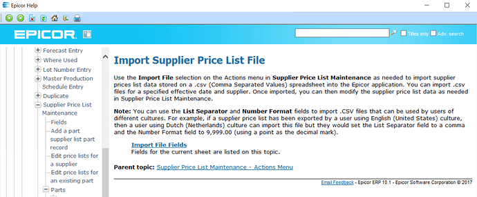

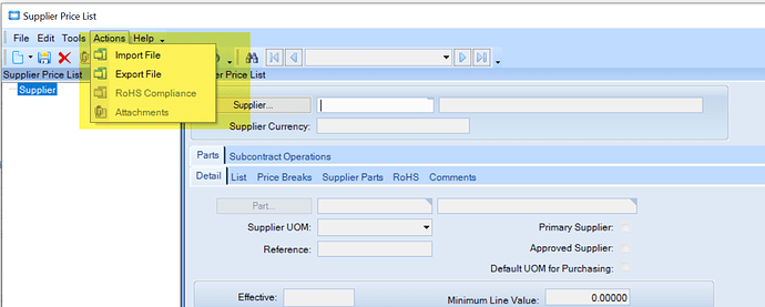

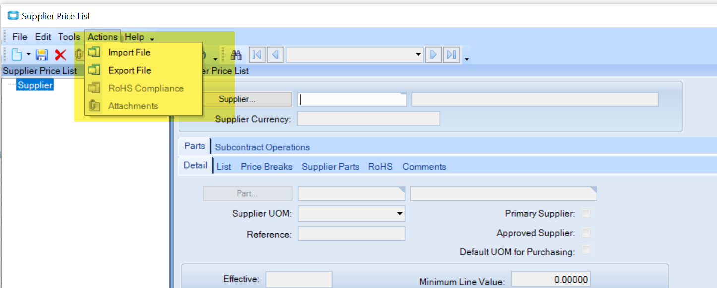

It is incredibly annoying to work with the supplier price list interface IMO. We use DMT to upload bulk changes. You don’t want that though… I noticed there’s an option to import per below. I wonder if you did an export and looked at the data, then it might give info on how you need to upload it. Actions / Import or Export in the SPL program. One thing to be wary of that has bitten us, you can have multiple supplier price list records accidentally if you do not realize, effective date is used as a key. To replace one SPL record with another, either upload with same part number, supplier id, effective date, OR delete existing one first then upload.

Thanks for the tips – I’ll have them investigate the import process. I guess too that I could write a REST API interface in our Intranet web to make it easier for them (basically do the same thing has the DMT tool is doing).
