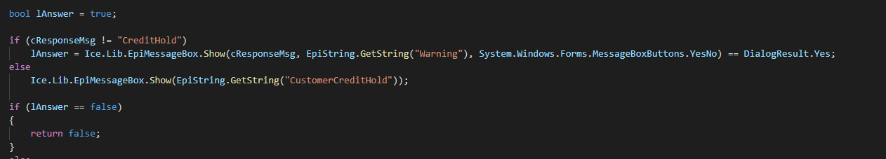

So when I review the source code I understand why that’s not working. Below is where the UI calls MasterUpdate and what it does when the update returns.
ordAdapter.MasterUpdate(lCheckForOrderChangedMsg, lcheckForResponse, this.LastView.ViewName, this.currentBTCustNum(), this.currentOrderNum(), weLicensed, out lContinue, out cResponseMsg, out cCreditShipAction, out cDisplayMsg, out cCompliantMsg, out cResponseMsgOrdRel, out cAgingMessage);
				savedShipAction = cCreditShipAction;

				if (this.throwHoldMessage && cResponseMsg.Length > 0 && checkCustCreditLimit && LastView.ViewName == "OrderHed")
					if (lContinue == false)
						Ice.Lib.EpiMessageBox.Show(cResponseMsg);
						return false;
				else if (this.throwHoldMessage && cResponseMsg.Length > 0 && checkCustCreditLimit && (LastView.ViewName == "OrderDtl" || LastView.ViewName == "OrderRel" || LastView.ViewName == "OrderMsc" || LastView.ViewName == "OHOrderMsc"))
						return false;
					else
						bool lAnswer = true;
						if (cResponseMsg != "CreditHold")
							lAnswer = Ice.Lib.EpiMessageBox.Show(cResponseMsg, EpiString.GetString("Warning"), System.Windows.Forms.MessageBoxButtons.YesNo) == DialogResult.Yes;
						else
							Ice.Lib.EpiMessageBox.Show(EpiString.GetString("CustomerCreditHold"));
						if (lAnswer == false)
							return false;
						else
							if (this.CounterSale && cCreditShipAction.CompareTo("WARN") == 0)
								lReadyToShip = (Ice.Lib.EpiMessageBox.Show(EpiString.GetString("OKShip"), string.Empty, MessageBoxButtons.YesNo) == DialogResult.Yes);
							this.throwHoldMessage = false;
							checkCustCreditLimit = false;
							if (currentView == "OrderDtl" && proposedView == "KitPartInfo")
								kitPartInfoView.dataView[kitPartInfoView.Row]["ShowKitDtls"] = !(Boolean.Parse(kitPartInfoView.dataView[kitPartInfoView.Row]["ShowKitDtls"].ToString()));
							ordAdapter.MasterUpdate(false, checkCustCreditLimit, this.LastView.ViewName, this.currentBTCustNum(), this.currentOrderNum(), weLicensed, out lContinue, out cResponseMsg, out cCreditShipAction, out cDisplayMsg, out cCompliantMsg, out cResponseMsgOrdRel, out cAgingMessage);
This section in particular is where it creates a local lAnswer variable sets it to true and then that gets set and checked again later. If it gets set to False from the answer dialog we normally see it drops out of the update. Unfortunately that exhausts the easy fix options.
I ran this through a live debug and confirmed with cResponseMsg empty it doesn’t even go through this check. What is happening is in the BO it’s not creating the line and when you click yes to this message somewhere in the UI, I think it might trigger an update with something else flagged that tells the BO to actually save the line.
